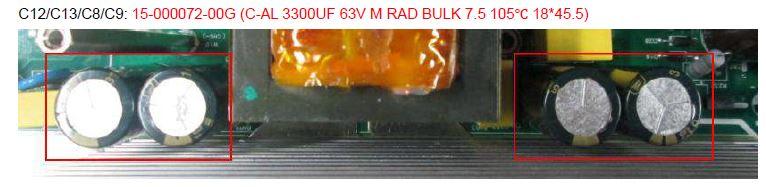

One follow-up question, @Coulomb: Is my understanding correct that the caps are the ones as per below (from page 12 of the Axpert service manual)?
I've found someone locally that can do the replacement for me and the shipment from Mouser should arrive during the course of this week
22 hours ago, wolfandy said:
Is my understanding correct that the caps are the ones as per below...
Yes, that's the ones that protect the MOSFETs, and that you should replace.
