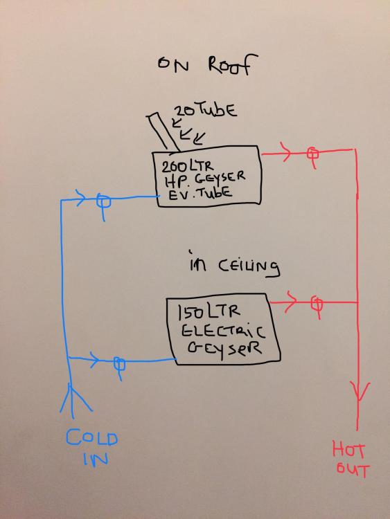

August 28, 20215 yr On 2021/04/11 at 10:35 AM, Rooney Hat said: Got the plumber to do the install, I'll test how much the temps between tap and ambient geyser differ, and if it's isn't a major difference, I can always add a small 1kw element to the old geyser that can be used with excess solar. I’m curious of how this worked out for you, did you test the system with any results? I did something similar but have put my two geysers in parallel, I have my old normal electric 150ltr geyser in the ceiling that I kept just as a spare and installed a HP evacuated tube 200ltr geyser on the roof about 2years ago. For the two years I have been using only the EV solar geyser and have switched off and drained the spare old geyser, but about May this year I had a small problem on the EV geyser controller that prevented me from using the element so I decided to re-instate the spare geyser in ceiling I opened it’s valves and switched on the element I also just left the EV tube geyser to carry on as normal, so-that I could see how it will work. Well it changed my mind on thinking geysers need to be in series only, as I have not had a day with anybody complaining about cold water since May. I have fixed my EV solar controller in the meantime but hardly used it. I now power the old geyser in the ceiling mostly with excess solar PV and because the two geysers both feed my taps at the same time the geysers seem to maintain higher temperatures at all times and need less heating. I think I will add a circulation pump now for the summer to circulate hot water through the two geysers it should assist in keeping the EV tube geyser more under control due to their extreme efficiency in summer when they tend to blow out hot water when temperatures can go over 89degrees.

August 29, 20215 yr 15 hours ago, Gerrie said: I’m curious of how this worked out for you, did you test the system with any results? I did something similar but have put my two geysers in parallel, I have my old normal electric 150ltr geyser in the ceiling that I kept just as a spare and installed a HP evacuated tube 200ltr geyser on the roof about 2years ago. For the two years I have been using only the EV solar geyser and have switched off and drained the spare old geyser, but about May this year I had a small problem on the EV geyser controller that prevented me from using the element so I decided to re-instate the spare geyser in ceiling I opened it’s valves and switched on the element I also just left the EV tube geyser to carry on as normal, so-that I could see how it will work. Well it changed my mind on thinking geysers need to be in series only, as I have not had a day with anybody complaining about cold water since May. I have fixed my EV solar controller in the meantime but hardly used it. I now power the old geyser in the ceiling mostly with excess solar PV and because the two geysers both feed my taps at the same time the geysers seem to maintain higher temperatures at all times and need less heating. I think I will add a circulation pump now for the summer to circulate hot water through the two geysers it should assist in keeping the EV tube geyser more under control due to their extreme efficiency in summer when they tend to blow out hot water when temperatures can go over 89degrees. Not so sure about having it in parallel like that. I have this almost exact setup except is in series, the solar geyser on the roof preheats water and feeds into my 200ltr electric geyser in the roof. Installed a sensor in the solar geyser to record the temperature. We now have almost endless hot water 🙂 I have a 2kw element in my 200ltr electric geyser which I heat up during the day to make sure we have at least 200ltr of hot water.

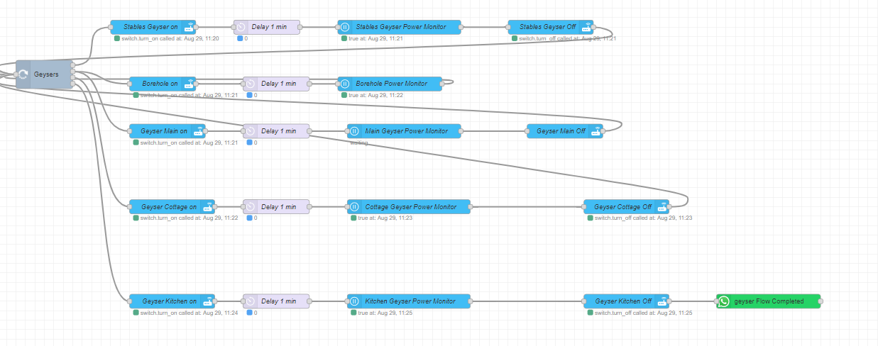

August 29, 20215 yr I have a flow in node red using Ewelink smart breaker switches to switch my geysers on and then switch them off when the thermostat kicks out and switch the next one on. Works very well and all my water is usually heated up by 13:00 and stops my inverter from getting overloaded.
August 29, 20215 yr 16 minutes ago, Sc00bs said: I have a flow in node red using Ewelink smart breaker switches to switch my geysers on and then switch them off when the thermostat kicks out and switch the next one on. Works very well and all my water is usually heated up by 13:00 and stops my inverter from getting overloaded. What software/system do you use to control all of this?

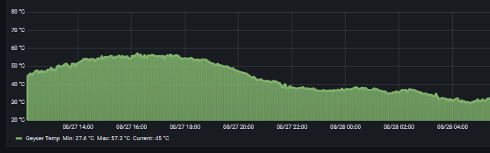

August 29, 20215 yr 53 minutes ago, Rooney Hat said: Would not expected the parallel to work as it should mix the temps It does mix and send hot water from the electric geyser in the ceiling to the evacuated geyser on top of the roof especially during the night, it took me a while to realize this because after everyone showered at night my EV geyser on roof would be say 44degrees and without giving it any power during the night it would sometimes be higher the next morning like 50degrees thats when I realized the hot circulation is happening. Unfortunately I cannot see the temperature of the geyser in the ceiling but would expect it to be slightly colder when it has not been powered for a couple of hours. 1 hour ago, Rooney Hat said: there is hot water nearly all the time, and the geyser only takes about 15mins to heat to 50 degrees at 4am, saving me battery power. Your first geyser in line seem to make the difference and is key for longer periods of hot water, I might change my system to series but for now I’m still experimenting with the parallel setup and am just wondering where to fit the circulation pump.
August 29, 20215 yr 41 minutes ago, Sc00bs said: Not so sure about having it in parallel like that. It was never my intention to run it in parallel like the but when I installed the solar geyser I did not want to remove the old geyser but rather keep it as a spare, as I thought removing a perfectly good geyser would be a waste.
August 29, 20215 yr 49 minutes ago, grant.cpt said: What software/system do you use to control all of this? I use Home Assistant with Node Red/InfluxDB & Grafana, links up to my Sunsynk 8kw inverter and gets all the production data from there. I use the solar power prediction in Home Assistant to make a decision at to what flows to run every morning at the start of the routine as I have a Node Red flow for low solar power days and one for high solar power days (pool etc) There are some instructions as to how to do it on the forum but have been thinking of doing a video guide 🙂

August 30, 20215 yr On 2021/08/29 at 1:23 PM, Sc00bs said: I use Home Assistant with Node Red/InfluxDB & Grafana, links up to my Sunsynk 8kw inverter and gets all the production data from there. I use the solar power prediction in Home Assistant to make a decision at to what flows to run every morning at the start of the routine as I have a Node Red flow for low solar power days and one for high solar power days (pool etc) There are some instructions as to how to do it on the forum but have been thinking of doing a video guide 🙂 Thank you! Def need to look at this. As I'm not fully utilizing the free energy from the sun at the moment
