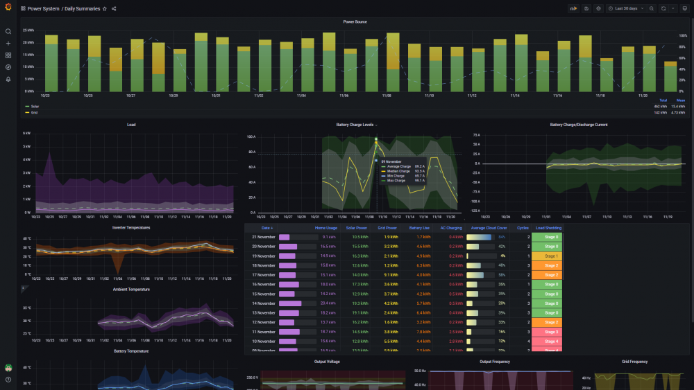

In my case so far with good planning my battery is usually fully charged by about 11:00,ย  I've been able to use my 3 KW geyser from about 10 in the morning by about 12 the water is hot and enough for 3 people to shower, in the evening the wife does all the cooking using an electric stove and the battery usually last until +_ 10ย  keeping at 20% DODย
See my consumption/ power generated in the last 30 Days.
432 KW/ H generated by my PV and 142 KW/H grid power.ย
