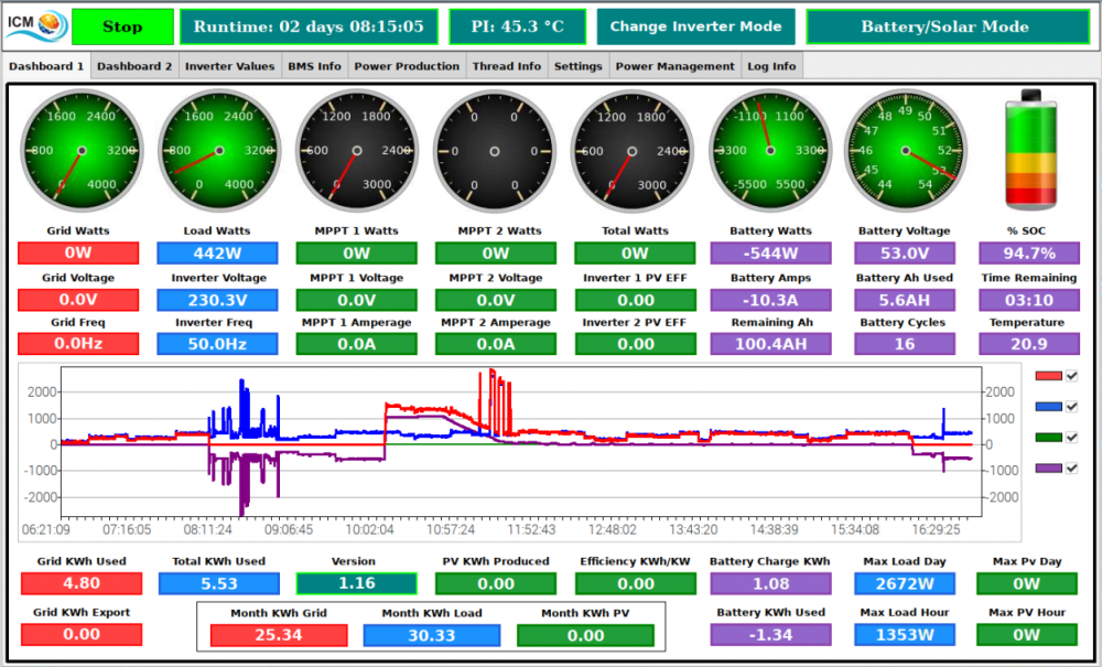

I also have a ICM raspberry pie for monitoring (also purchased second hand from a forum member). So all in about R37K, please note that it has NOT been installed in my db yet. Below is a screen of my current status 45 mins into loadshedding.

17 hours ago, uDuWaR said:
I picked up one of the thesunpays 4KW inverter from a fellow forum member for R4k then purchased the US3000C for about R19K, I decided to return it and purchase a Hubble AM2 (about R28K now) as the pylon's are .5C this mean they can at max only output half their rated power. A pylon US3000C is 3.5kwh therefore it can only about about +-1800w. Too low for my 4kw inverter.
We run two laptops, TV, desktop pc, wifi, lights and as long I don't run two elements at the same time (kettle and dishwasher) we don't go near the 4KW limit and only use +- 20 % during loadshedding.
I'm curious as to the logistics of it, how are you wired to run all those devices\appliances without DB integration?
Lolz messy extension cords 😕 until I can get it installed into the DB
