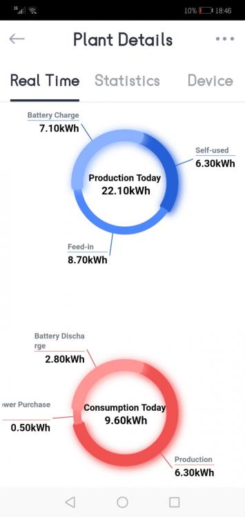

My neighbour recently installed a Sunsynk inverter and having a look at his app, there is something not making sense. He is using maximum PV power for the whole day and I see there is Feed-on power of 8.7kwh which I can't seem to see where it is going. He has not used anything on the non-essential side and all I can think of is that it is going back into the grid?
The penalties are quite severe, get him to change that asap and set it to zero export and do not tick the sell option. Some prepaid meters will simply bill you for the energy exported too, so he will end up paying double for power.

Or he can wait for a cloudy day and catch up then?
If the meter is one of the old ones, exporting to grid will work fine and the meter will turn in reverse.
But as iiznh says some meters will turn forwards instead of reverse, charging you for exporting to grid. Just Check with his installer

It is not a prepaid meter and it is an electronic one.
Electronic meters will probably bill you for the power no matter the direction of the power.
Even if the meter is one of the old ones with the disk (some of them have reverse direction blocking and get stuck) you are not allowed to export, paying the penalty/fine will kill the ROI of you whole install.
