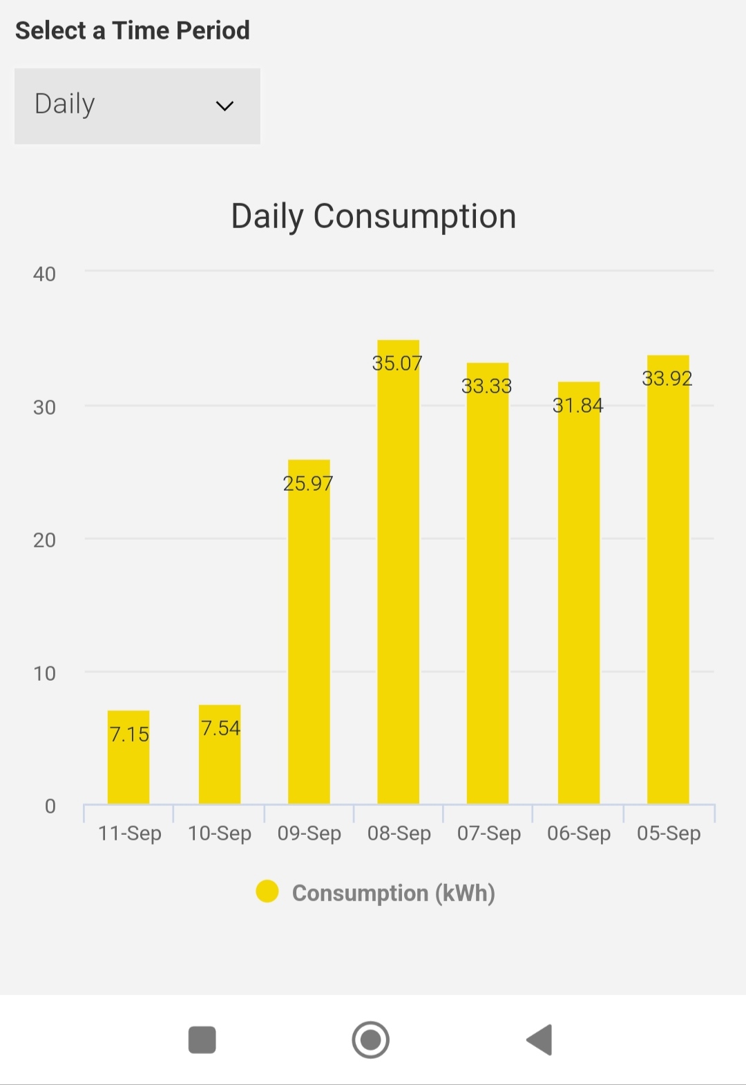

September 12, 20223 yr Author Thought I would share an update just got the geyser installed last week and the results so far are great. No running out of cold water Power consumption is massively down. Just want to monitor the gas use now. geyser was installed on the afternoon of the 9th sept Hoping it will pay itself off soon. Thank u all for your huge help here!!🥳
