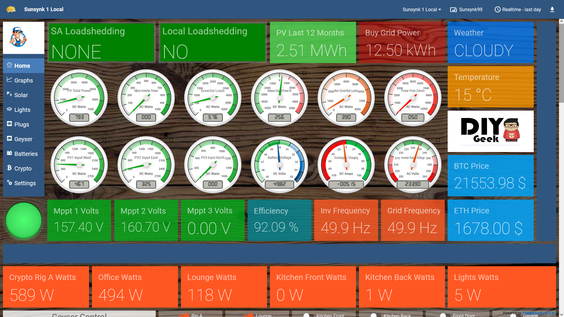

On 2022/08/25 at 1:30 PM, system32 said:
  • Sonoff Power Monitor Pow R2 - 15A - for lower power devices (not geysers)
  • Sonoff Smart Geyser Switch - 25A - for geyser
Sonoff devices are really awesome and once flashed to tasmota you have total ownership of your data :)
Also Visia powerplugs - can also flash tasmota
I already have my crypto rig(Powr2), lounge(visia), kitchen(visiax2), lights(Powr2) and geyser(powr3) done.
