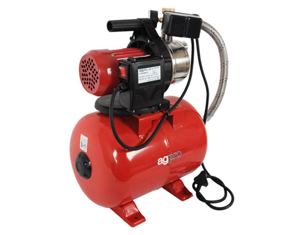

June 11, 20233 yr Hi Raiden2912 Seeing you have 10100 litres capacity I do not see any problems with the flow of water into the borehole as it filled the tanks. If your .75kw motor is not strong enough to pump the well so that the flow is reduced to just filling, the borehole tests I mentioned will not be able to be done with any meaningful results. The picture you request is I suppose for a bladder tank (pressure tank) which I have attached. The pressure tank will also need the appropriate switch on the pump to work correctly. The pressure tank can also be part of the motor assembly.Pressure-Tanks-2021-V1.pdfPressure-Tanks-2021-V1.pdfPressure-Tanks-2021-V1.pdfPressure-Tanks-2021-V1.pdfPressure-Tanks-2021-V1.pdfPressure-Tanks-2021-V1.pdf I have also attached my calculations on how I worked out my flow rate and borehole capacity. Borehole Capacity Test 26072022.docx Edited June 11, 20233 yr by Peter Topp

June 13, 20233 yr Hi Scorp007 How will this work? as soon as you open a tap the pressure drops it will start the pump. A pressure tank works because of the two setpoints for the start and stop of the pump from the pressure switch, as well as the 1.8bar pressure on the bladder.
