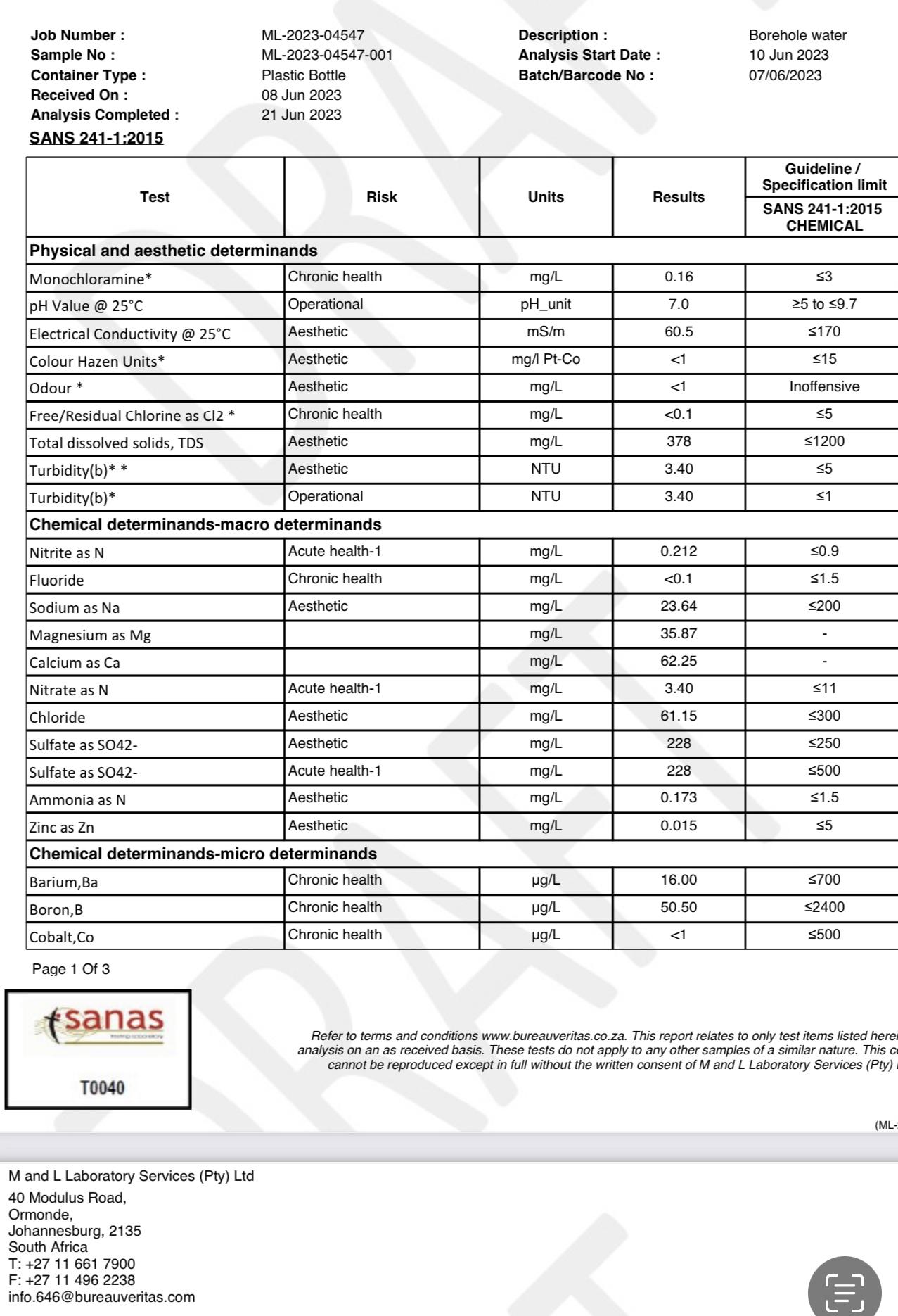

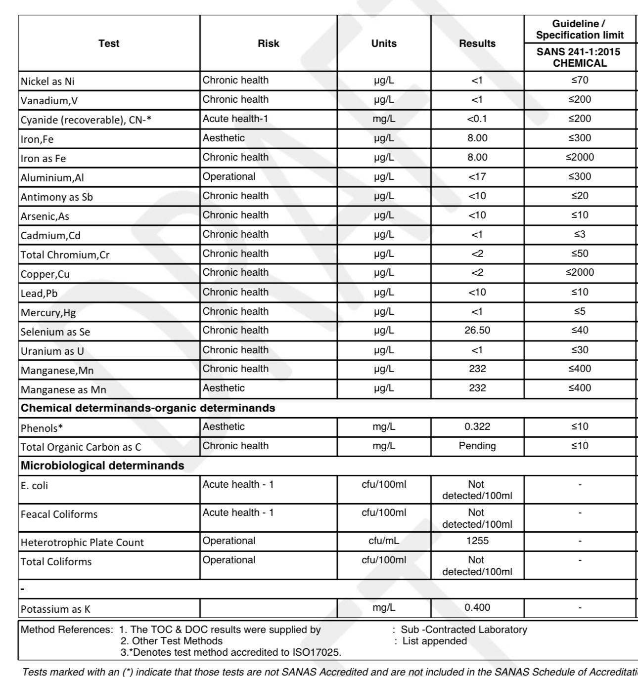

I’ve received my report back.
not sure yet how to read this…any help will be highly appreciated.
Edited by Raiden2912
Its a different lab from the one I used so not sure what the conclusion on it is. And can't seem to find the HCO3- (bicarbonate) value to plug into the link I posted. Hopefully the installer or someone here can help more
Hi Raiden 2912
After going through your report your water looks perfect for consumption.
The only figure that is not in specification is the turbidity (cloudiness). This can be due to being a new borehole with still some solids and is common with newly drilled boreholes.
This can be overcome just by putting in some filters to trap the solids. The turbidity should improve as the borehole is used over time.
As far as the ph. goes you cannot get better as it is totally neutral ph7 which is not acid and not alkaline and will not damage anything.
I don't know if a report analysis was attached. This is all I can see from the report.
I am not an expert at this and I might have missed something.
I suggest you should have the borehole checked again after a year or two as in my case the ph. had changed after a year.
I think the HCO3 (bicarbonate) value would be the amount of carbon dioxide dissolved in the water which makes it more acidic and would be more prevalent in rainwater as it absorbs CO2 on the way down. I do not think it has any bearing on the report as the ph. is 7 (I could be wrong).
Edited by Peter Topp
Thank you so much Peter and Robbo.
so on this on the report I’m a little concerned about is the Heterotrophic Plate Count? Check the recommended and what was picked up.  I’m not sure how to fix that. Still doing research cause the report also says draft for some reason. They should offer some guidance per the diagnosis as well.
this is awesome though. Thank you so much
I think this may be because there is a value pending for "Total organic carbon as C" which is listed as a chronic health risk, so I guess they will wait for those test results first before sending the final.
As for the Heterotrophic plate count, I don't think it's too serious as they don't have a limit for it and it is listed as an operational risk, not health risk, so I think it is more about wearing impellers and clogging pipes like the turbidity. They have tested for coliforms which are a health risk separately by the looks of things. You might also find that this is related to a new borehole as organic material from the surface will have entered the hole during drilling.
Wait for the final report, I'm sure they will give some guidelines on any health risks.
After reading up on the Heterotrophic plate count there are indications that the count should be less than 500 however, a larger count does not mean that the water is a problem as the bacteria could be harmless.
If you want to eliminate and lower this you can implement the following. A UV light source would be the best bet as it damages the DNA in the microbes. Adding an activated carbon filter also helps. Using continuous chlorination, however, the chlorine will have to be reduced by carbon filters before it is drinkable and helps with the taste. Excess chlorine is not good for you. Doing reverse osmosis will also help to remove bacteria.
You could also boil the water for consumption before anything else is implimented in you are worried which also works.
