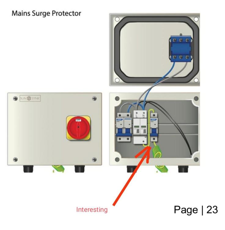

1 hour ago, Scorp007 said:
Just out of interest I find this method in the Sunsynk manual with respect to the MCB on the earth wire at a SPD.
That is quite interesting it purpose🤔 maybe to protect the SPD from large surge currents
