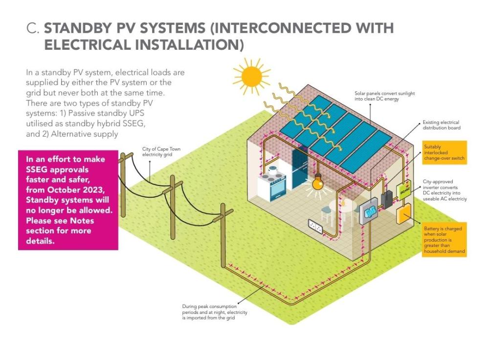

Standby ( UPS ) Systems Will No Longer Be Allowed. ( their fancy info-graphics are not so disguised scare tactics )
They are e...ing insane, but I do understand why they are having this knee-jerk reaction ( nothing to do with safety as so many keep defending them on )
