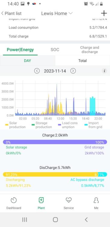

I have installed a dongle and PV Butler and attached are some screen shots. I have a few comments and questions and would like your comments and answers if applicable.  Note that the file 2023-11-11 is only a few hours of data from when the system went operational.
As I see it, during the day I have plenty of power and made no use of the grid at all.  This included boiling the kettle a few times, running the dishwasher and washing machine, watching TV in the day and evening and also use of the microwave around 18H30.. My battery is also fully charged during the day.  As I see it come about 22H00 or thereabouts, I usually make some tea and boil the kettle.  The battery at that stage is about 50% to 60% and then the inverter switches to the Grid and it appears that the battery is charged to full capacity.  Today at 00H00 the battery was at 90% and at 06H05 at 62%.  Sun came up and at 08H55 99%.  The wave is a saw tooth ranging from 99% down to 93% at 10H55 and 15H55 96%.  Today I ran the washing machine and dishwasher starting at about 09H00.
From what I see my SP's and battery is quite capable of running my home - in a normal daylight situation.  However just as I mahe a cup of tea at 22H00 the grid kicks in and I use, in my opinion anyway, 2KW of power for about 2 hours. That, as I see it is about 4KWH of electricity bought that if I had waited a few hours would have got for nothing.  Is my logic correct?

My geyser is not on the inverter and that is definitely the Grid charging the battery.  Lots of developments since then.  Had an independent inspect everything and found major issues.  Effectively the whole system has been reinstalled.  Original wiring from panels to inverter was AC wiring, DB board wired with wrong gauged wires; DB to inverter wired with wrong gauged wires; 6 x 550w panels now 3 strings of 2 panels and not 2 strings of 3 panels; installed a 2nd 4.8KWH battery.  So as you can imagine a whole new ballgame.  To cap it all I insisted that a final COC be issue by an independent 3rd party of my choice.   The sweetness of the whole thing is that the tab was picked up by the original installer, after a bit of :hereby", "Notwithstanding", "without prejudice", etc.
So my monitoring and records I kept are out the window and I'm starting on a clean slate.
