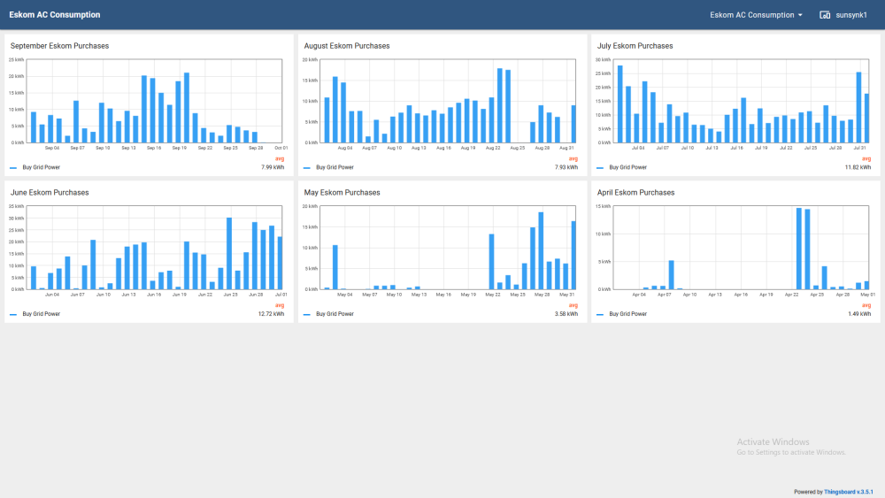

As mentioned by a few members already, try getting some data, that will go a long way to start visually understanding your solar setup.
Check your inverter, most today have some sort of data logging that you can view.
Else at the very least try graphing your eskom bill or bought units ti visually start seeing your usage.
e.g. below, my last 6 months eskom purchases, being in Cpt this winter has been a bit harsh with clouds and rain, so ended buying quite a bit of power
My usual summer months I average less than 2 units per day from eskom.
Grid use for 2022:
This year to date:
Winter 2023 was a rather wet and cloudy affair compared to previous years.
Since I do not export to the grid, as soon as the batteries are full the mppt units pull back. So Solar totals can be much higher if allowed to export.
From the start of 2023 I've gotten a lot 'smarter' in managing loads with automation and scheduling. Home Assistant pulls data directly form the Victron Cerbo and now switches the geysers, pool pump etc on and off. This is where the savings happen. Switching your big consumers to times with ample sunlight and free power.
More panels are going up over the summertime to help with generation in winter. Currently got 5760W on the roof and they have been there since 2014. Going to add another 4kW.

On 2023/10/13 at 6:38 AM, Scorp007 said:
@Bobster. You have great stats on your system so you can as a test disable the timer for the heat pump and leave it on during a 24h period and check how many times it comes on to keep the temp at your normal setting.
Then compare it to if it was off say during the night and do one heating cycle early in the morning.
The results might answer the doubt about timers saving a bit of power or not. Share your findings.

I'm reluctant. I have a 4.6 kW inverter, and this is surprisingly easy to overload. One of the reasons I've had the heat pump on a timer is that this creates a time slot in the morning in which appliances can be used without us having to worry about the heat pump (which is backed up) running at the same time. And it creates another slot in the afternoon which I can use to heat the guest geyser using solar.
I also don't want to have it running at night, or not yet, because it will draw from the batteries.
But I have set it so that it turns on at 6:00 and will be left on until 15:00. We'll see how that goes.
I don't know if we'll get anything conclusive. There's only two of us, so not a lot of showering going on (keep your smart remarks to yourself). We run the washing machine on a cold cycle. Etc. Plus we have a lot of insulation on the main geyser and the hot pipes are lagged.
What I'd like to know is how to get these graphs and data from the inverter
