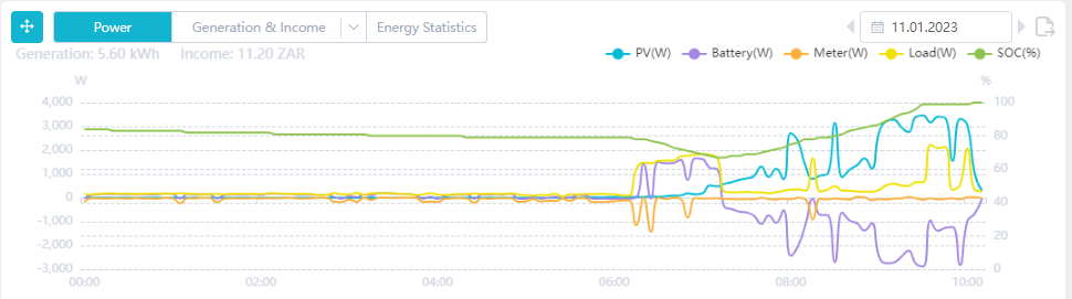

Do you have access to any sort of system monitoring tool. Something like this
though it won't be the SAME as this, becaus this is from my Goodwe inverter, using the online Goodwe portal.
But note that the yellow trace is total load, orange is the grid (down means I'm drawing), and the purple trace is the battery. For the latter, beneath the zero axis means battery charging, above means battery is discharging. Just after 6:00 you can see the draw from the battery increases - that's my heat pump starting up.
So if you have something like this then instead of relying on deduction and inference, you can KNOW what loads are on the system and how it is responding to them. And we could see if, as I have guessed/deduced, your system is actually using grid for everything when grid is available.
But I think this is a settings issue. Grid is prioritised before battery and PV.
This brings us back to the second matter I touched on, which is having a rule in place so that you can only discharge the battery so far whils the grid is up. This leaves you with a guaranteed minimum amount in the battery when the grid goes down. Again, I can't advise on settings for your inverter. I would advise that you err on the side of caution and watch how things go and how the system behaves. Another reason these monitoring tools are so useful.
Think back to the friend I mentioned. I understand his caution, but since he's set that reserve level so high he is not saving much money. So he is going to start slowly and incrementally reducing that setting watching to see how far his battery goes and checking his own comfort level. That's the way we all have to do it (if we know that there is this setting, otherwise the installer sets and forgets).
