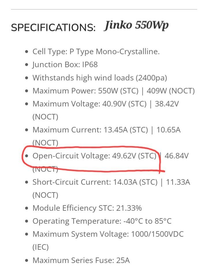

Just take note if the installer want to use 10 x 550Wp solar panels they need to use both Mppt's in 5S1P configuration. 10S1P configuration on 1 MPPT could cause damage as the maximum Dc input voltage of 500v would be exceeded. The perfect fit for SS 5kw inverter would be 6 x550wp 6S1P on each Mppt totaling 12x550w= 6600w.
Voc for 6×550wp =298v+8%=322v. Below Screen print for Jinko 550Wp panel.
