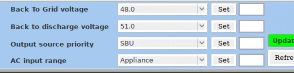

Do you have the Pylon comms cable for ICC to receive data from the Pylon BMS? If yes, then I would change the 'Back to Grid Voltage' and 'Back to Discharge Voltage' to make sure that the Axpert's settings do not interfere with ICC switching modes (assuming that you are then also using 'Using SOC for Control' on the battery tab)

Great. But then I would recommend the following to ensure that ICC is switching between modes based on the SOC from the Pylon BMS instead of the Axpert based on voltage readings:
  • Set 'Back to Grid Voltage' to 47V
  • Set 'Back to Discharge Voltage' to 58V
  • Enable 'Using SOC for Control' on the battery tab and set your desired SOC values (keeping in mind that if your batteries will not fully carry you throughout the night the Axpert's self-consumption will still be drawn from the Pylons even while running on utility)
