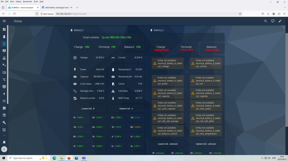

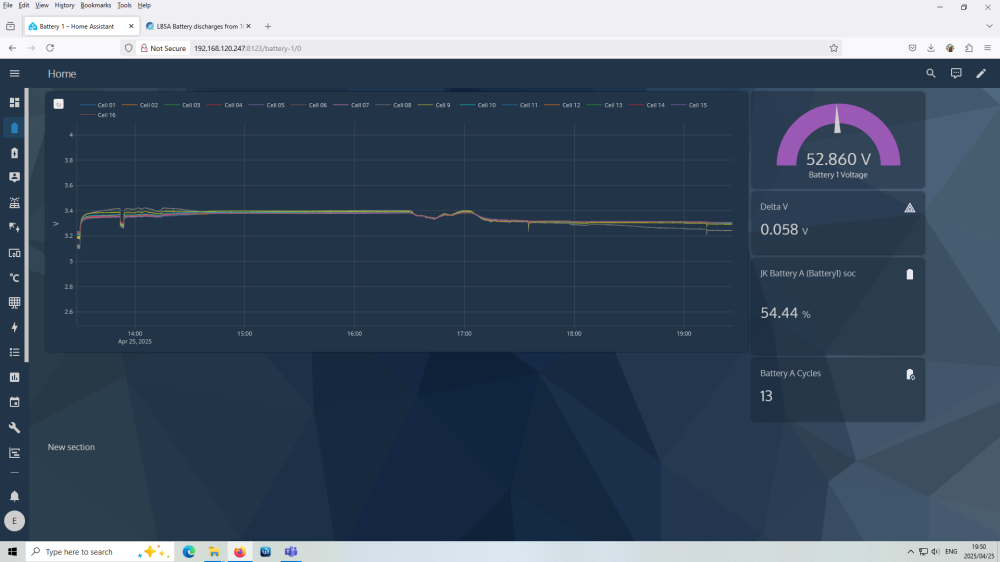

Hello Nive,
look at dashboards bellow
I have one LBSA 5 Kw for close to 4 years now.
I have my own monitoring system using Modbus protocol.
I can see every single parameter from the seplos BMS.
No complains except from day one, of the cells cell's (cell number two never reaches full charge).
Bain knows about, as I've informed BMS technical people, they offer to repair it, but I would have to take the battery to your workshop.
I decided to live with it and so far, it has performed well.
Up to date I got almost 3 MW/h out of it, good value for the money.

Hello Nive,
I have been your best test bench for about 3 1/2 years and I have the archive data to prove it.
Normal runing conditions during load shedding.
I've been running my battery on use define since day one.
Charging current set to 20 Amps, very seldom may change it to 30 Amps, depending on weather conditions.
I will try set the Bulk charging to 56.8 V and float at let's say 56.6 V, I don't know if the Seplos BMS will allow it, it may stop charging and change to equalizing mode once cells reach 3.51 V
Wii let you know the results soon. I should a full battery by about 11:00 Am.
Thanks for the prompt reply.
Cheers.

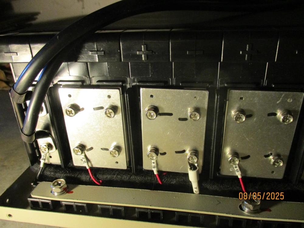

That has inspired me. I had a similar issue with my newest purchased Leoch 48100-S pack. From the beginning cell 15 showed significantly higher voltage at charge and lower at discharge. However it couldn't go flat like yours because it's parallel connected with 5 other packs. This being a brand-new pack I contacted the official importer and seller, Averge, with a guarantee claim. But they didn't want to do anything about it. After having red your post I copied it in an email to them and asked to allow me to open the pack without voiding the guarantee to check the cells connections. They wrote me the permission and so I did. I tightened all M4 hexagon bolts of the cell bridges with a socket wrench. Some allowed up to a half turn. After reassembly and re-connection the issue with cell 15 no longer persists. It looks like all cells run the same voltage within a few mV. This proves to me that all cells are in good health. Below pictures taken of the opened pack.
The cell bridges consist of a plate with 2 M4 bolts for each cell terminal. To the left the negative leads to the BMS. Also visible the BMS voltage connections on each bridge.
I think it might be a good idea to do such service after a number of years and expiration of guarantee.
