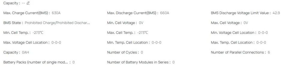

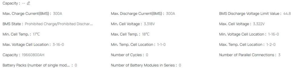

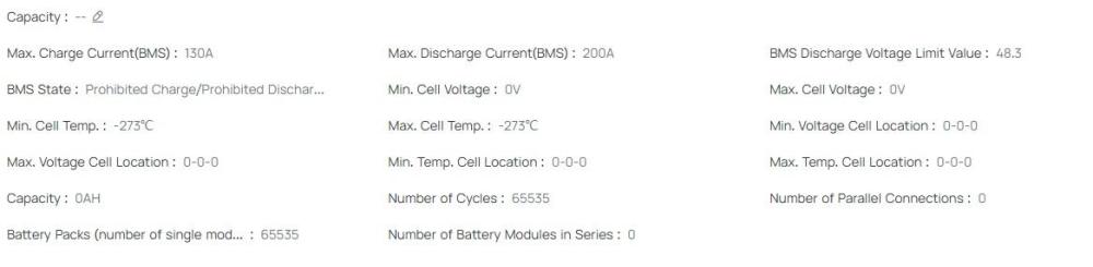

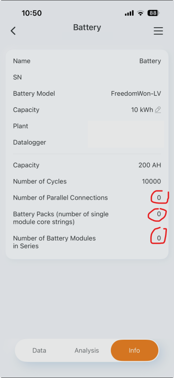

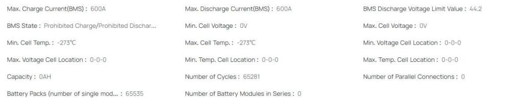

Tuesday at 04:305 days I logged a request last year in October for Solis to enable ability to view FreedomWon eTower:Accurate multiple Battery cycles - on App and Web portal - still nothing has been doneBattery packs (number of single module core strings - on App and Web portal - still nothing has been doneNumber of Battery Modules in Series - on App and Web portal - still nothing has been doneKindly assist and attend to this as this needs you to work with FreedomWon R&D team, thank you.

Thursday at 08:493 days On 2026/07/07 at 7:16 PM, HennieL said:Hi @Moffat , Solis will not know that you posted this if you do not quote the original poster, or mention a Forum member with an @ tag. Let me do this for you...@Solis Inverters SA - A Client needs your assistance - kindly see above.Many thanks for the tag @HennieL. Number of cycles keeps going up and down as well. Today it's 10,000 on another day it had come down so clearly there's an issue with accurate comms and or capture of data either by inverter or being sent by the battery FreedomWon eTowers. I've also attached screen shot with circles in RED of area that have no info.I've also closed off personal info so that any update is done, not just for me but for ALL comms between FreedomWon eTower batteries and Solis S6 pro hybrid inverters and I know, not everyone is interested in granular information as much as I am, but it's important to have it. Edited Thursday at 08:573 days by Moffat

Thursday at 10:393 days Hello Everyone,The core issue here is not with the Solis inverter hardware or firmware it’s with what data the battery’s BMS actually sends to the inverter via the CAN bus.Why Freedom Won eTower shows limited information:The Freedom Won BMS only transmits a limited set of data points to the Solis basic SoC, voltage, current, charge/discharge limits, etc.Detailed parameters that Moffat is looking for such as individual pack cycles, number of battery modules in series, core strings, and granular per-module data are simply not being reported by the Freedom Won BMS in the CAN messages for the Solis profile.Solis can only display what the BMS sends. If the BMS doesn’t include that data, the app and web portal will show blanks or incorrect values e.g. fluctuating cycle counts.Freedom Won would need to release a BMS firmware update that expands the CAN data set for Solis compatible profiles. This is something they have done in the past for other issues. Kynee batteries for example:Kynee batteries use a more advanced/smart BMS that actively populates all the available fields that Solis supports including detailed cycle information, module counts, etc.Their BMS is better aligned with the richer data protocol that Solis expects, so everything shows up correctly on the Solis Cloud app and portal.Note on other popular brands: Some other popular battery brands also show similar limitations with detailed data on Solis it ultimately comes down to how comprehensive their BMS implementation is.Point is: Solis inverters rely heavily on the battery manufacturer’s BMS to supply rich, accurate data. When the BMS is comprehensive like Kynee, you get excellent visibility. When it’s more limited as with the current Freedom Won eTower, you only see what the BMS provides.Freedom Won has a good track record of resolving these things via remote firmware updates it might be worth tagging them directly or contacting their support to request an expanded Solis CAN profile.Here are a couple of examples of BMS Reporting on the Solis Cloud and you will note the many different and incorrect bms reporting issues this spans over 4 Battery brands on different sites. Some report battery pack count incorrectly others report Battery capacity incorrectly or temperatures incorrectly the point is the Battery BMS dictates what values are reported.
Thursday at 11:043 days 20 minutes ago, Powerforum Store said:Hello Everyone,The core issue here is not with the Solis inverter hardware or firmware it’s with what data the battery’s BMS actually sends to the inverter via the CAN bus.Why Freedom Won eTower shows limited information:The Freedom Won BMS only transmits a limited set of data points to the Solis basic SoC, voltage, current, charge/discharge limits, etc.Detailed parameters that Moffat is looking for such as individual pack cycles, number of battery modules in series, core strings, and granular per-module data are simply not being reported by the Freedom Won BMS in the CAN messages for the Solis profile.Solis can only display what the BMS sends. If the BMS doesn’t include that data, the app and web portal will show blanks or incorrect values e.g. fluctuating cycle counts.Freedom Won would need to release a BMS firmware update that expands the CAN data set for Solis compatible profiles. This is something they have done in the past for other issues.Kynee batteries for example:Kynee batteries use a more advanced/smart BMS that actively populates all the available fields that Solis supports including detailed cycle information, module counts, etc.Their BMS is better aligned with the richer data protocol that Solis expects, so everything shows up correctly on the Solis Cloud app and portal.Note on other popular brands:Some other popular battery brands also show similar limitations with detailed data on Solis it ultimately comes down to how comprehensive their BMS implementation is.Point is:Solis inverters rely heavily on the battery manufacturer’s BMS to supply rich, accurate data. When the BMS is comprehensive like Kynee, you get excellent visibility.When it’s more limited as with the current Freedom Won eTower, you only see what the BMS provides.Freedom Won has a good track record of resolving these things via remote firmware updates it might be worth tagging them directly or contacting their support to request an expanded Solis CAN profile.Here are a couple of examples of BMS Reporting on the Solis Cloud and you will note the many different and incorrect bms reporting issues this spans over 4 Battery brands on different sites.Some report battery pack count incorrectly others report Battery capacity incorrectly or temperatures incorrectly the point is the Battery BMS dictates what values are reported.My take too. It's not an inverter issue if the BMS does make the info available to it. The comms betwen inverter and BMS is largely dictated by the BMS. @Moffat did you log a ticket with Freedom Won at all? It's where I would start, if I had your issue.
Thursday at 11:053 days 8 minutes ago, Powerforum Store said:Hello Everyone,The core issue here is not with the Solis inverter hardware or firmware it’s with what data the battery’s BMS actually sends to the inverter via the CAN bus.Why Freedom Won eTower shows limited information:The Freedom Won BMS only transmits a limited set of data points to the Solis basic SoC, voltage, current, charge/discharge limits, etc.Detailed parameters that Moffat is looking for such as individual pack cycles, number of battery modules in series, core strings, and granular per-module data are simply not being reported by the Freedom Won BMS in the CAN messages for the Solis profile.Solis can only display what the BMS sends. If the BMS doesn’t include that data, the app and web portal will show blanks or incorrect values e.g. fluctuating cycle counts.Freedom Won would need to release a BMS firmware update that expands the CAN data set for Solis compatible profiles. This is something they have done in the past for other issues.Kynee batteries for example:Kynee batteries use a more advanced/smart BMS that actively populates all the available fields that Solis supports including detailed cycle information, module counts, etc.Their BMS is better aligned with the richer data protocol that Solis expects, so everything shows up correctly on the Solis Cloud app and portal.Note on other popular brands:Some other popular battery brands also show similar limitations with detailed data on Solis it ultimately comes down to how comprehensive their BMS implementation is.Point is:Solis inverters rely heavily on the battery manufacturer’s BMS to supply rich, accurate data. When the BMS is comprehensive like Kynee, you get excellent visibility.When it’s more limited as with the current Freedom Won eTower, you only see what the BMS provides.Freedom Won has a good track record of resolving these things via remote firmware updates it might be worth tagging them directly or contacting their support to request an expanded Solis CAN profile.Here are a couple of examples of BMS Reporting on the Solis Cloud and you will note the many different and incorrect bms reporting issues this spans over 4 Battery brands on different sites.Some report battery pack count incorrectly others report Battery capacity incorrectly or temperatures incorrectly the point is the Battery BMS dictates what values are reported.@Powerforum Store you are very correct in the information you have shared and I engaged FreedomWon customer care and technicians in this regard and they advised that the whole process of updating the BMS information and it's display would require collaboration between FreedomWon and @Solis Inverters SA . I continually engaged FreedomWon over many months and they in turn blamed Solis team for not their unavailability, now whether that is true or not, I have never been able to verify it hence raising it here that this issue has been outstanding since last year October (2025) when I first raised it including official tickets with FreedomWon, which they kept insisting on closing and eventually went quiet. Previously I was not even able to get the basic information such as:Total Battery capacity (Ah) for more than one module - this was fixedTotal Battery capacity (kWh) - I requested if this could be received on the Solis inverter automatically - this is still done manuallySo the question is whether @Solis Inverters SA got any joy from FreedomWon or not and clearly since this outstanding, it means someone somewhere dropped the ball or thought my request was not important. What FreedomWon sent me was a RS232 cable so I can get information directly off each battery module and information for diagnostic purposes and I even recommended that since that cable is difficult to buy maybe it be sold together with their battery modules.Their distributor was not willing to assist me, in the first instance, as I had bought the battery directly from the @Powerforum Store. My battery had a loom issue and fortunately FreedomWon had a technician travelling to train the distribution personnel and in Zimbabwe and during that time he was able to then resolve my battery issue under warranty, so am very grateful to them for that.I not had any issues with the FreedomWon batteries reliability, to be fair, but I always want to be aware of issues before they escalate or deteriorate, hence having granular information is important, at least to me. Battery sellers and installers (some but not all) are normally interested only in the initial sale and after service is asking for the moon, clearly. So that's my backstory to raising the issue here.
Thursday at 11:123 days 6 minutes ago, Yellow Measure said:My take too. It's not an inverter issue if the BMS does make the info available to it. The comms betwen inverter and BMS is largely dictated by the BMS.@Moffat did you log a ticket with Freedom Won at all? It's where I would start, if I had your issue.Yes @Yellow Measure I logged the issue and they said they would get in touch with Solis R&D to work on this. This issue is still outstanding. Last comms I did on the matter was in January 2026 with team at Solis Zimbabwe support and it's always a back and forth blame game till eventually I got frustrated and tired. Edited Thursday at 11:153 days by Moffat

Thursday at 12:093 days 52 minutes ago, Moffat said:Yes I logged the issue and they said they would get in touch with Solis R&D to work on this.Great!52 minutes ago, Moffat said:This issue is still outstanding. Last comms I did on the matter was in January 2026 with team at Solis Zimbabwe support and it's always a back and forth blame game till eventually I got frustrated and tired.I think that's where the lines got crossed. You correctly raised the issue with Freedom Won, and you need to hold them accountable for a solution. There can only be one accountable entity, not two. It sounds to me like you believed their excuses and became a ping pong ball.
