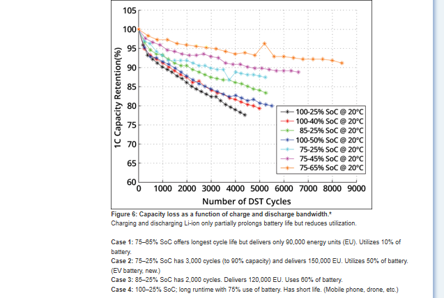

@Tsa that is correct. Now all the questions start eg % charge and DOD and what the best settings are. been reading on battery university the following article
https://batteryuniversity.com/index.php/learn/article/how_to_prolong_lithium_based_batteries
Interesting what they say...
Basically Running at full charge is not ideal ??
@Coulomb  what is your take on this ?
Interesting. It certainly shows that charging to 3.6 VPC (100% SOC for LFP) isn't good for battery life, so it reinforces my arguments for a more moderate top charge voltage (51.8 V instead of 53.2 V).
But it looks like it would be even better to limit the charging to 75% SOC; this seems to deliver the most total energy over the life of the battery. That means spending even more money up front (to cover the lost 50% of capacity per cycle), to save more money over the total life of the battery.
I note that between cases 2 and 3, you need an extra 20% of battery capacity, to deliver an extra 25% of total energy. So that's really only about a 5% saving.
I found it interesting too. So at the moment my BMS is set to max charge of 95% and min of 50 %
So according to this theory set your top to 75% the low to 25% how would the float voltages work then ?

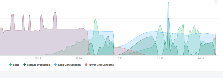

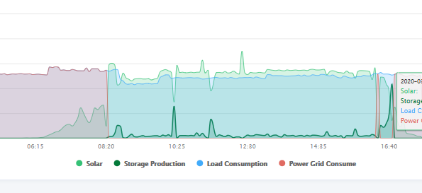

This is me on a sunny day
And this a day like today with rain
