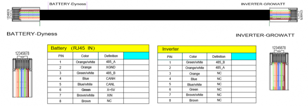

@Tsa - I'm battling to find the manual or link that refers to the CORRECT pin outs - The V2.0 Growatt manual (page 8 only shows the one side - IE - Pin1, Pin2 - not the crossed side  - but I clearly remember seeing this somewhere - maybe Growatt sent me the engineering schematics of the pin outs at some point - trying to find it again. Where did you find the correct pin outs?
Whats interesting is that I assume a correct BMS cable is not supplied in the box - seems some distributors throw a cable in the box, others not - so wondering if this is not the reason why people are struggling - incorrect cables mostly.
What also seems to be a challenge is different manual versions. Dyness Powerbox (lets say V1.0) shows the dip switches like the pictures earlier posted -  off/on/off/off for Growatt - but the latest powerbox manual (V2?)  makes a distinction. It says : "for Growatt uses off/on/off/off" - but then also "for Growatt SPF off/on/on/off" - added in a later revision.. confusing as hell.
Just glad people are finally having some success with it talking properly.
Both sites seem to show the "newer" FW:
Edit:  Found this is a Dyness manual:
Seems Pin out is 1 - > 2, 3 -> 1

Thx.. so Dyness also supplied the correct pin outs - strange the Growatt doesn't show this clearly. Even more strange that your's had a BMS cable in the box!

Double check the comms cable pin outs are correct as well.

Growatt BMS port to  Battery  IN port?
I would still confirm the pin outs just to be sure.
battery PIN1 to inverter PIN 2,battery PIN3 to inverter PIN 1
Setting on inverter (05 = Li) and then (36 = L01).
Edited by Tsa
Yes, you would typically only need those pins.
