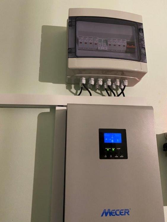

Essential items in a Solar installation
Fuses, fuse holders, circuit breakers, general purpose house wire, solar wire, trunking,

How important is it to earth your solar
Well that is a good question there are a couple of reasons that is necessary. One reason is for a measure lightning protection so there is a short as possible route for the electrical current from a lightning strike to travel. Electricity always flows to the shortest route.
Secondly transformer less high frequency inverters Transformer less inverters require the solar panels on the roof and the framing system they are installed on to be earthed. This is due to the fact that transformer less inverters can potentially allow some AC voltage to the DC side (the solar panel side) of the solar power system with respect to ground. If the solar panels and the solar panel mounting system are not correctly earthed they could potentially give an electric shock if touched.

I presume it is still best practice to earth your panels, even with a low frequency inverter where there may not be AC present on the PV side?  I can just see how an insurer would jump at that to refuse a lightning-related claim...
Indeed if your solar array is not earthed and installed correctly using spd and fuses besides properly earthed solar arrays will have a measure of protection against lightning and the risk of destroying your expensive inverter and batteries are also reduced. Insurance companies will not pay your claim sadly many so called professional installers do not bother to earth solar arrays or even install fuses and spd devices between the panels and the Mppts also they neglect to install fuses between the batteries and the inverter. The client suffers the damages at the end of the day..
So it's very important to always make sure your panels are earthed if not for insurance purposes for safety reasons. I would not be impressed if my very expensive inverter goes up in flames because of someone taking shortcuts.
