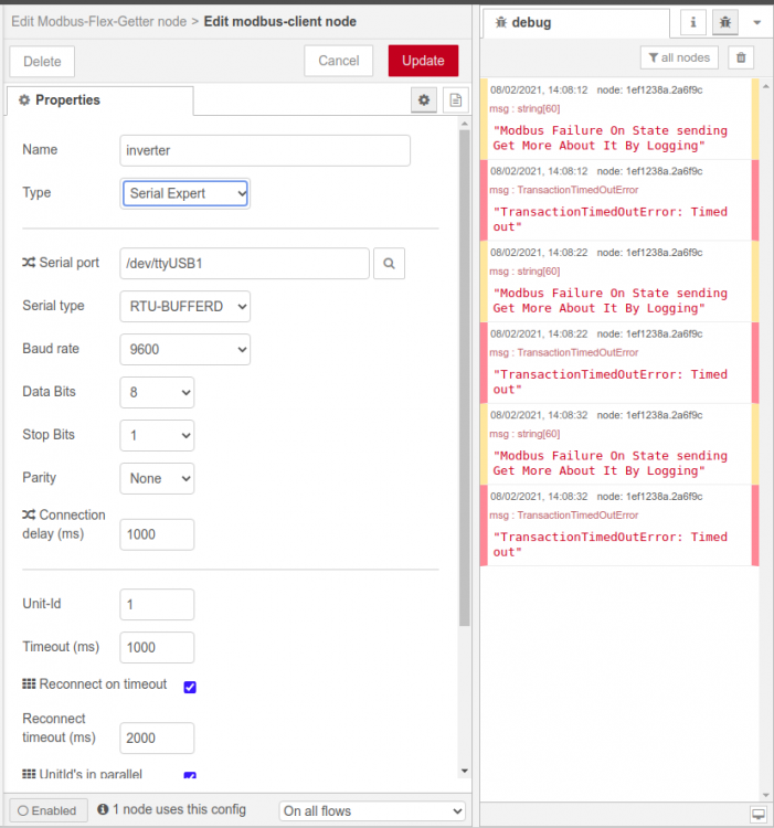

ojeysky Posted August 15, 2022 Share Posted August 15, 2022 On 2021/02/08 at 2:09 PM, ojeysky said: Have a look at my settings on flex getter, is that not correct? Here is the settings that has been working fine for me. However, after a firmware update today, I have not been able to fetch data with the connection above. Does anyone know if something has changed with the Deye modbus register? Quote Link to comment Share on other sites More sharing options...
swazz99jhb Posted August 15, 2022 Share Posted August 15, 2022 Double check your Unit Id hasn't changed. Happened to me with a firmware upgrade. Quote Link to comment Share on other sites More sharing options...
ojeysky Posted August 15, 2022 Share Posted August 15, 2022 12 minutes ago, swazz99jhb said: Double check your Unit Id hasn't changed. Happened to me with a firmware upgrade. Thanks can you kindly confirm where to find the unit ID? what I used on node red in the past was 1 Quote Link to comment Share on other sites More sharing options...
swazz99jhb Posted August 15, 2022 Share Posted August 15, 2022 Think the upgrade changed it to 00. I changed it back to 01. Quote Link to comment Share on other sites More sharing options...
ojeysky Posted August 15, 2022 Share Posted August 15, 2022 (edited) 4 hours ago, swazz99jhb said: Think the upgrade changed it to 00. I changed it back to 01. Thanks a lot. Just to log my experience here. I use a Deye and tried changing mine to 1 but the inverter tripped off and when it was power cycled, it defaulted back to 0 so I just updated on node-red instead and all is now fine. Thanks Edited August 15, 2022 by ojeysky To help someone in future. Quote Link to comment Share on other sites More sharing options...
