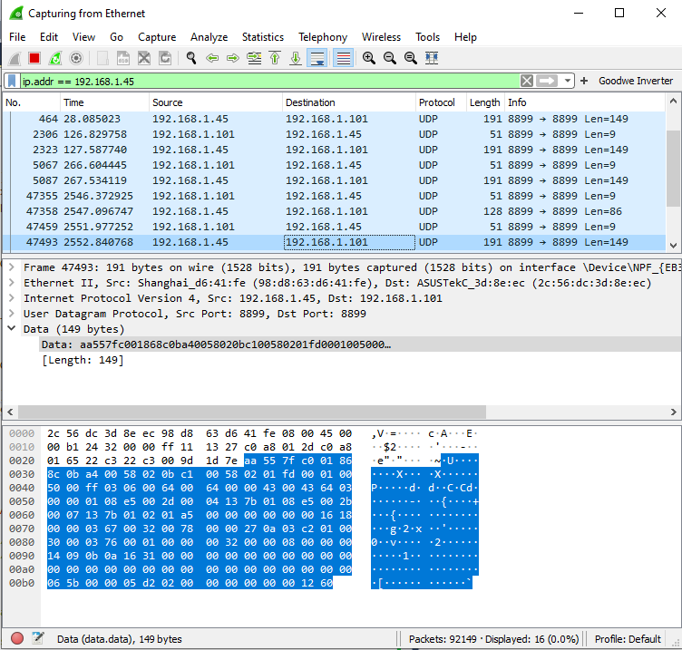

Running PV master on a mobile device and a packet sniffer running in the background, I managed to log some interesting data in order to allow me to talk to the inverter through it's network interface. I've made some progress, but this is very much a work in progress; decoding the data is a bit of a challenge but I think I'm about halfway identifying all the data. I'm posting this here as hopefully someone else has a bit more insight and can help filling in the missing blanks, or at the very least, it might help someone with a bit more smarts to crack it properly.

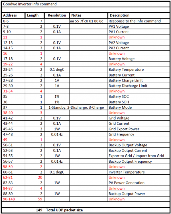

Basically, the communication between PV Master and the inverter is in the form of UDP packets with the inverter listening on port 8899. Because it's UDP, it's connectionless. There's no need to explicitly connect to the inverter (as would be the case for a TCP connection), it simply sits and listens for the relevant requests and then broadcasts back with the results. Nice and simple, although (because of the inherent handicap of the UDP protocol) there's no guarantee that there will be a response. In testing I've had responses from the inverter in most cases, but it did happen where the response went missing. So, you'll have to make sure your implementation is robust enough for this case and for ensuring that all the data packets do arrive and that they are complete. There is a checksum in the inverter's protocol in order to validate the data, but it's something to take note of.
There's a few requests you can send the inverter, and based on that the inverter can respond with things like it's model/serial, it's status or confirmations whens you change settings. For the most part I'm only interested in getting the inverter status. Interestingly, there's no authentication mechanism. You fire off the request, and the inverter will answer - provided your request makes sense.
I've attached a document outlining the information I was able to decode from the information request response from the inverter. Still a few blanks there but the results are encouraging. In order to get the response below, you need to issue the following bytes to inverter IP on port 8899: 0xaa, 0x55, 0xc0, 0x7f, 0x01, 0x06, 0x00, 0x02, 0x45. The 6th byte is the request type and the 9th byte is the checksum. For the purposes of this exercise I won't go to deep into the various requests you can send to the inverter.

  • Sooo, I've had a bit more time to fine tune and verify the data. I've also managed to expose a few more bits of info from the packets; it's about at a point where there's enough identified data to be

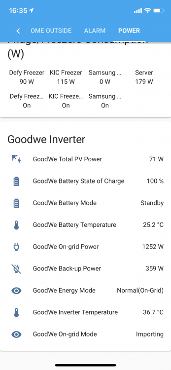

  • Aaaaand we have liftoff. Still a few bugs to sort out with the parsing of the power figures but success! There's a loooot more info available from the integration but I'll add that once everything has

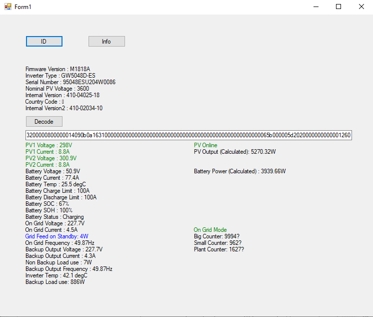

Sooo, I've had a bit more time to fine tune and verify the data. I've also managed to expose a few more bits of info from the packets; it's about at a point where there's enough identified data to be useful for logging. The idea is for this parsing to be done by a python script that runs every few seconds to feed into Home Assistant. When I have a little more time to mess with it I'll get that going, running on a Pi on my network.
Below is where I'm at. Items in black I'm 99% confident of, items in Red still needs to be verified properly. Some of the AC wattage stuff isn't 100% accurate, I suspect those are VA values, not Watts, and I've not figured out if the protocol reports power factor in order to get the AC consumption figures correctly calculated.

Aaaaand we have liftoff. Still a few bugs to sort out with the parsing of the power figures but success! There's a loooot more info available from the integration but I'll add that once everything has been nicely verified. The author really did us all a solid by doing all the Home Assistant backend stuff.

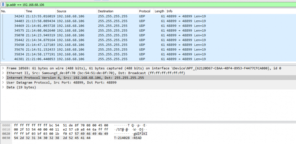

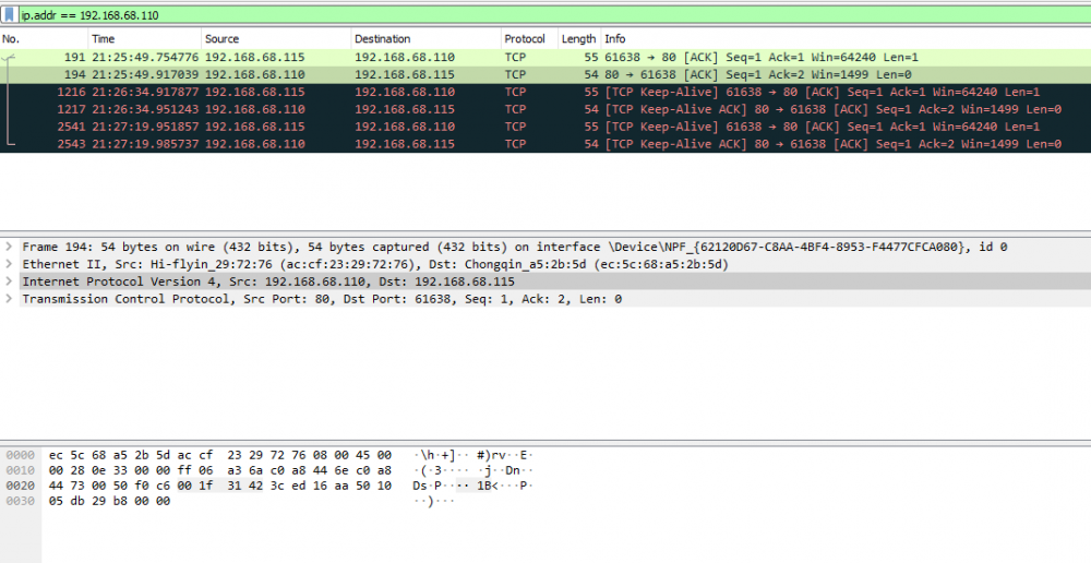

I downloaded Wireshark to my laptop to see what is going on on the network and it was surprisingly difficult to identify the Goodwe.  Eventually I found it and I can log into it from my laptop.  So I know the IP address is correct and it is connected.
I first scanned my phone's IP address and opened the EzManager app.  I can see it is sending packets via UDP to 255.255.255.255 using port 48899 but nothing is going back.  In the meantime the app is working and getting data from the inverter via the network.  Then I open the PVMaster app and the same happens.  I'm stumped.
322965221_Screenshotphone.thumb.png.7256117eb15c457facb94a2d1778c270.pnget some gibberish
Then I scan the Goodwe's IP and get some gibberish via TCP:
For the life of me I can't figure out how the app and the Goodwe are talking to each other.  Am I using Wireshark incorrectly?  Any ideas?
Yebo, you can’t use wire shark that way. While UDP packets are broadcast, your switch prevents those packets from flooding the network. The switch is routing the relevant packets directly between your phone and Goodwe dongle. It’s not available on the rest of the network. You’ll have to run a packet sniffer on the phone with the PV master app to get the relevant packets. That’s how I got the data initially.

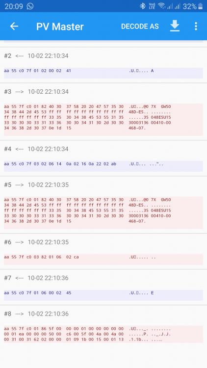

Thanks, this helped a lot.  I installed Packet Capture on my phone and picked up the packets.

That sounds...difficult. I simply used an app called tPacketCapture on an Android tablet that had PVMaster installed. Those saved captures were opened in Wireshark and it gave an idea of what was happening. Nice and simple.
@mletenayactually used some hacking process to decompile the PVMaster app and managed to get much quicker results than I had in trying to decode the protocol. Be that as it may, the UDP protocol is 95% understood and documented currently, so I seriously doubt anyone will need to go the packet sniffing route again.
