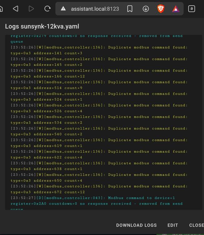

Hi everybody! So I've been running my ESPHome + Sunsynk 12kva for many months now without issue. Then a few days ago it started showing weird stats like 40,000% battery charge and 60k kw solar. It would record these readings intermittently, so if I looked at my history graphs there'd be insane spikes that would last minutes to hours.
I figured it was loose connections as I never soldered the wires and that's caused issues before, no dice.
Now, after fiddling with the wires, its not even reporting data.
I reinstalled ESPHome with my .yaml onto the ESP32, no dice.
Ran the log and found this (see screenshots)
Has sunsynk changed some modbus addresses or is my EPS32 just cooked? I checked my .yaml and there are no duplicates.
Lets see the code, looks like you might have multiple modbus controllers as it talks about Modbuscontroller:136 & 043?
Maybe something with one of the ESPHome updates

So I've found that the read error is only when my batteries are at minimum, which is 15% (then it reports 44,474% almost constantly), or when SunSynk Day PV is at zero then it reports 6,483.1 kWh every hour or so, and SunSynk Day Grid Import just randomly reports 1,333kWh
Here comes the code:

All looks good @BobTheDinosaur , I suspect that it has something to do with your ESP32/RS485
So i've replaced both my RS485 and ESP32 (matching voltages now) and got ESPHOME set up and running again, all sensors are working but my problem remains. I have regular, intermittent absurdly high readings on a few sensors.
@slipx have you got any ideas?
I found this post which seems to have the same problem as I do, at least when looking at his debug info for his battery SOC.
https://community.home-assistant.io/t/modbus-errors-on-sunsynk/604063
What did you replace the RS485 with @BobTheDinosaur?
The MAX485 boards are often problematic and I think it may have something to do with their RS485 running at 5V and the inverters running at 3.3V
I changed to a 3.3V RS485. I think i found it on this thread, but it's this one.
https://www.communica.co.za/products/wvs-rs485-3-3v-breakout-module?variant=44563441254700
To me it's looking like a code issued. Something to do with the modbus comms. Which is why I'm hoping Slipx has some ideas.
Nice board @BobTheDinosaur, I haven't see that one before

@slipx,@kellerza, @Sc00bs
Update and some progress, hoping Kellerza has some insight into this.
My ESP32 has always been plugged into the inverter's Modbus port ("Modebus") and worked great for months. I read on a thread here that solarassistant advises using the 485 meter port. So I switched today.
https://powerforum.co.za/topic/8451-sunsynk-inverter-monitoring/page/24/
While on the Modbus port the esphome logs were showing lots of chunks CRC errors, when switching to the 485 meter port those CRC errors reduced drastically in number and frequency. The problem still hasn't gone away with the registers I mentioned in my post above. Though my dev buddy has helped by applying a filter with two options to the Battery SOC register:
    filters:
      - filter_out: 44474
#      - clamp:
#          min_value: 0
#          max_value: 100
#          ignore_out_of_range: true
As the error was a consistently intermittent 44,474 kWh the first filter did the job.
I found some related posts here:
https://github.com/kellerza/sunsynk/issues/63
Now this begs the question, should I be on the BMS port using a splitter?
Or should I factory reset my inverter and see what happens?
