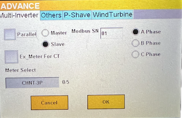

I managed to successfully set up ESPhome and HA Dashboards using @slipx configs and dashboards following @Sc00bs video tutorials. Thank you gents, it looks like a lot of effort went into this, thank you for sharing your hard work with the community. I hit one snag which took a while to figure out so I thought I would post it here incase anyone had the same issue. Maybe this has been documented and in my haste I missed it.
I set everything up but was not getting any sensor readings on my ESPHome provisioned ESP32. I was getting "[W][modbus_controller:136]: Duplicate modbus command found: type=0x3 address=150 count=1" errors. The ESPHome yaml configuration I was using had the modbus_controller address as "0x01".
It turns out that my SunSynk 8kW Inverter had the "Modbus SN" setting in Advance menu set to "00"
When I changed it to 01, the ESPHome started reading the correct sensor readings. Changing this setting requires switching the inverter off and back on again to clear a Grid Mode Change alarm that is generated. What is interesting is you can't even change the Modbus SN back to 00 so not sure why it was set to that value in the first place.
Edited by Gambit

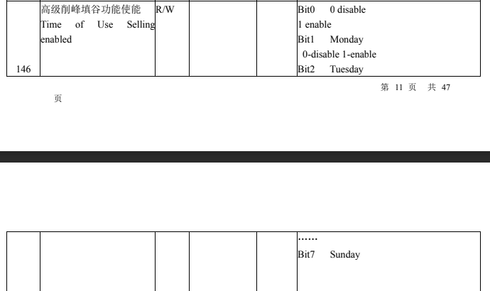

Have any of you been interested in register 146 for 3 phase inverters? Currently we only use on and off time of use, but I got interested in the days of the week yet. Does anyone know how to do this?
