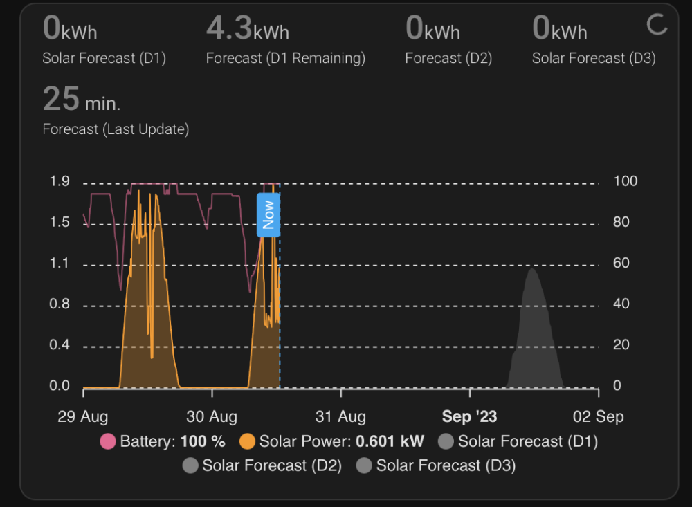

slipx06, any idea why I'd be having only day 3 showing potential PV and not tomorrow and day after...
G
Did you only enable the “long term forecast”? 🤣
G
Have you looked to see what your solcast sensor is reporting for tomorrow:
sensor.solcast_forecast_tomorrow
no value.
guess thats the problem... but why.
G

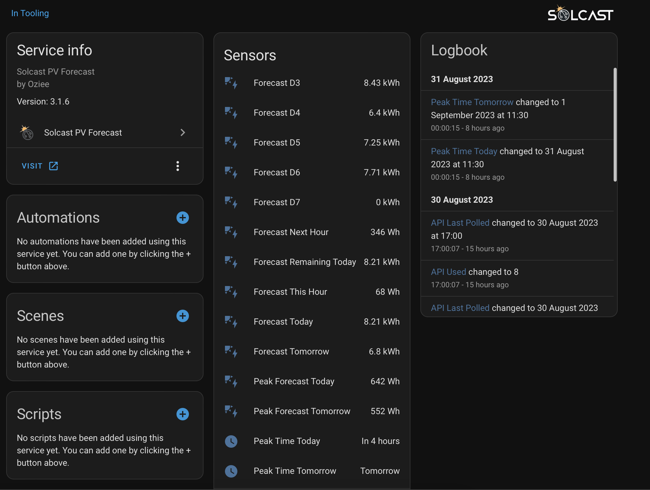

Try this one as a trouble shooti g step found under Add intergration. At the start I found solcast incredibly inaccurate. It also out of the blue just stopped updating 2 weeks ago. I dont know if you aware you need to apply for an api key and all that stuff

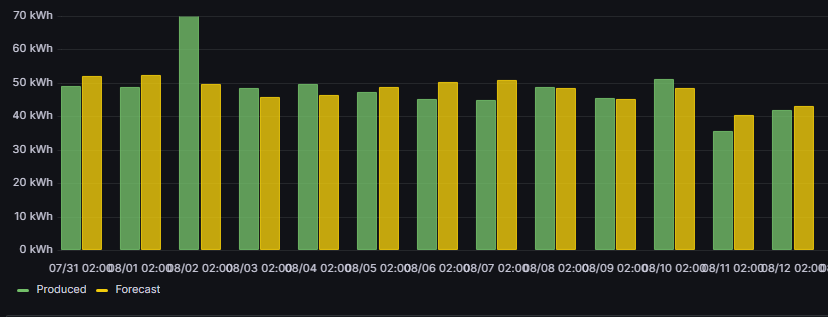

I have actually found Solcast to be very accurate.
I currently have 2 arrays mapped to my profile as I have an East/West split.
Here is a record of my Forecast vs Actual produced, bearing in mind that not all the available power was used resulting in lower production totals.
awesome will have to give it another shot

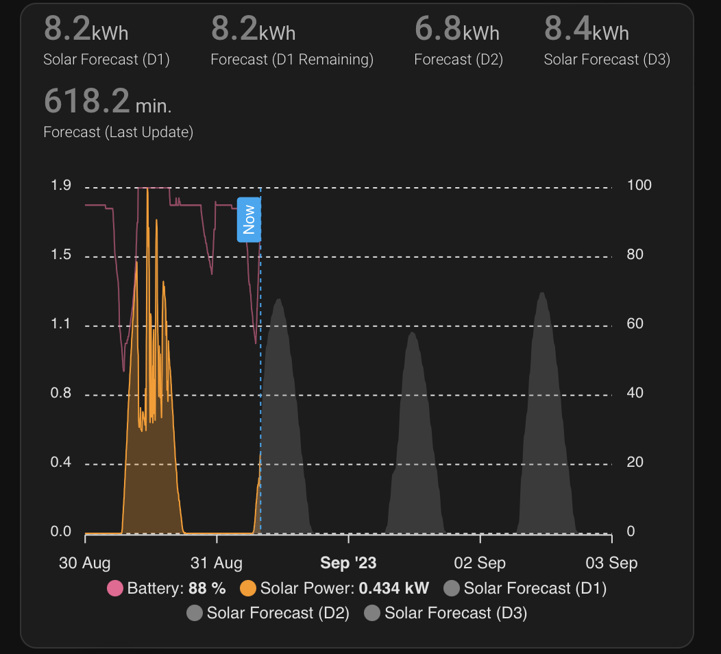

think i found my problem. my tomorrow is shown as just sensor.forecast_tomorrow and not solcast_forecast_tomorrow.
amusing... for the Sunsynk i ended with sunsynk_sunsynk_<sensorname> and now I'm loosing a name, he he he...
G
