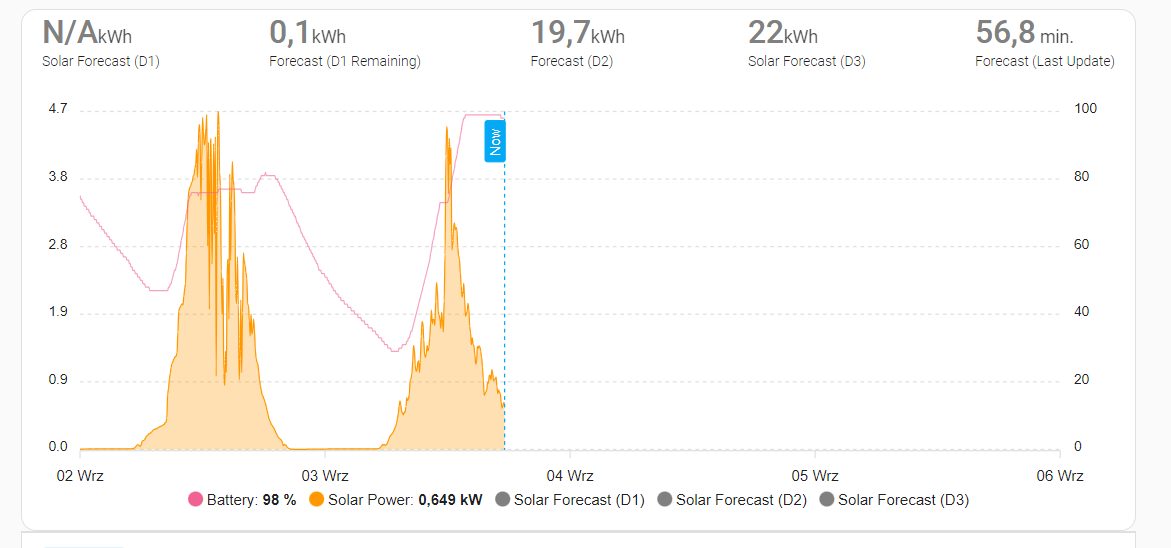

Hi, I am new here, however I managed to install the dashboard.
I have a problem with displaying the forecast production for the following days. As you can see below I only have what PV is currently producing.
I checked the data and it seems to be correct:
Today there was an update to the program, I currently have version 4.0.2
Thanks for all the tips!
That looks correct. Check these entities in your graph, specifically the data generator part as this renders the grey solar forecast for D1, D2 and D3
  - entity: sensor.solcast_forecast_today
    name: Solar Forecast (D1)
    extend_to: false
    color: grey
    opacity: 0.3
    stroke_width: 0
    yaxis_id: kWh
    show:
      legend_value: false
      in_header: false
    data_generator: |
      return entity.attributes.detailedForecast.map((entry) => {
            return [new Date(entry.period_start), entry.pv_estimate*2];
  - entity: sensor.solcast_forecast_tomorrow
    name: Solar Forecast (D2)
    float_precision: 3
    extend_to: false
    color: grey
    opacity: 0.3
    stroke_width: 0
    yaxis_id: kWh
    show:
      legend_value: false
      in_header: false
    data_generator: |
  - entity: sensor.solcast_forecast_d3
    name: Solar Forecast (D3)
    float_precision: 3
    extend_to: false
    color: grey
    opacity: 0.3
    stroke_width: 0
    yaxis_id: kWh
    show:
      legend_value: false
      in_header: false
    data_generator: |
Thanks for the suggestion. I had the wrong attribute detailedForecast.map.
