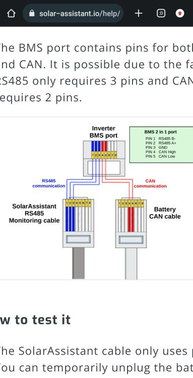

5 hours ago, Donovan_kk1997 said:
Hi All
I have literally tried everything above. I receive all the sensors however all values are 'unknown'. @sjlouw i have tried your exact setup but having no luck.
I receive the below log. I have removed the resistor R7 and also tried disconnecting VCC however am just having zero luck. See below:
INFO ESPHome 2023.8.2
INFO Reading configuration /config/esphome/esphome-web-cca1e4.yaml...
INFO Detected timezone 'Africa/Johannesburg'
WARNING GPIO4 is a Strapping PIN and should be avoided.
Attaching external pullup/down resistors to strapping pins can cause unexpected failures.
See https://esphome.io/guides/faq.html#why-am-i-getting-a-warning-about-strapping-pins
INFO Starting log output from esphome-web-cca1e4.local using esphome API
INFO Successfully connected to esphome-web-cca1e4.local

Check your connections to the Ethernet cable to the inverter are correct.
Is the cable wired up as a T568A or T568B, the cabling is different.
Most cables are T568B
Also if you using sunsynk 5kw have you tried the top middle port. Most likely the same one your battery can is plugged in. Marked rs458/can not the one marked with a red squareScreenshot_20230804_012030_Chrome.thumb.jpg.9fff66994d6ec6829621e05312647a9e.jpg
so i remember having a cable with a A plug, and deciding I rather wanted B so I crimped as per B, then I show a how where I connect the doubled up cables onto the dev board.
I have a factory made A cable... so might try that, (might be my crimping thats bad).
G
Attached is where I patched into.top left open RS485 port
fyi, checking the connections. so long, B wiring i believe.
@XianZA my middle port reads BMS485/Can, and is currently used by I'm guessing the battery. If I can temporarily use it to check cabling then sure, but I don't want to change/move anything the installer did.
As I read it the left port reads RS485 Meter ??
G
Your image is exactly like mine. That means the middle port bms485/can is what you must use. On the cable part yes using own crimping can be a nightmare. Get a factory made working cable and cut it , then determine which wires are on pin 1 and 2.
G
RMS meter did not work at all for me. So stick to the middle. You will need a splitter. I used a splitter.
