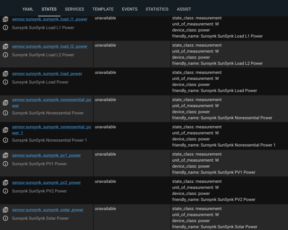

... understand why I'm not getting data atm, as I've removed the esp32 to permanently soldier cables into place and resolve the splitter requirement...
but why would all these values be unavailable? (surely they should have populated when it was connected)

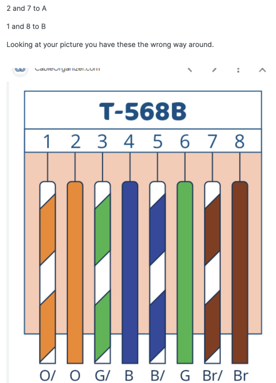

while making splitter... I assume the cable coming from the battery follows RG45 B standard  also.
So that I can make the RG45 going into the BMS port B based connecting to 2 blocks that B based ?
G

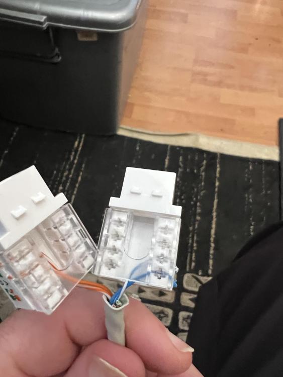

... looking at the splitter... and the 3 cables... and the presence of the Gnd.. and colours and looking at my connections...
Attached is how i got it wired. onto a RG45 B plug.
no where do I get to the 3rd pin for ground as per splitter requirement.
G
11 hours ago, Sc00bs said:
If it is a B you will need to switch to the Orange twisted pair
please explain, my RG45 is B.. so which of the 2 Oracle cables goes onto A and B on the dev board.
think this was my root cause.
As I got it wired as per: attached
G
ok, so O/W goes to dev board: port B and O to port A. and other side of cable is RG45 B crimped.
thats 2 cables going into the RG45 block. but when i then look at a splitter setup they ref 3 cables (points 1,2 and 3)... the 3rd (G/W) being the gnd which we have not connected to anything.
EDIT, removed brown& Brown/White usage.
G
Edited by georgelza
7 minutes ago, WesleyR said:
ye, will have a look, just curious how/why they show pin 3 used for gnd as it's not cabled to the dev board.
thinking about making a splitter... RG45 B wired one side going to two received blocks both also B wired.
Was just trying to take that wiring diagram of theirs and over laying it on what we have and does not add up.
I'm assuming the BMS is using pins 4 and 5, aka the Blue and Blue/White cables.

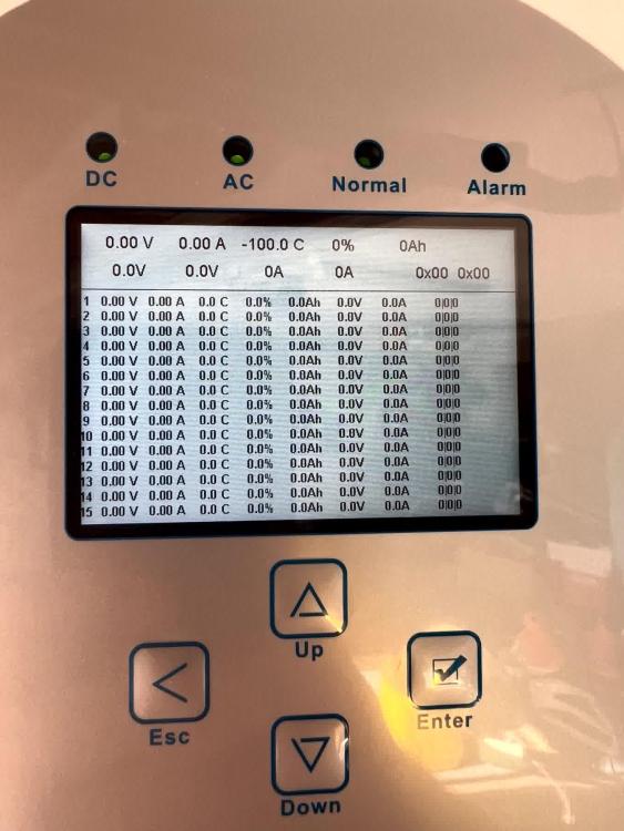

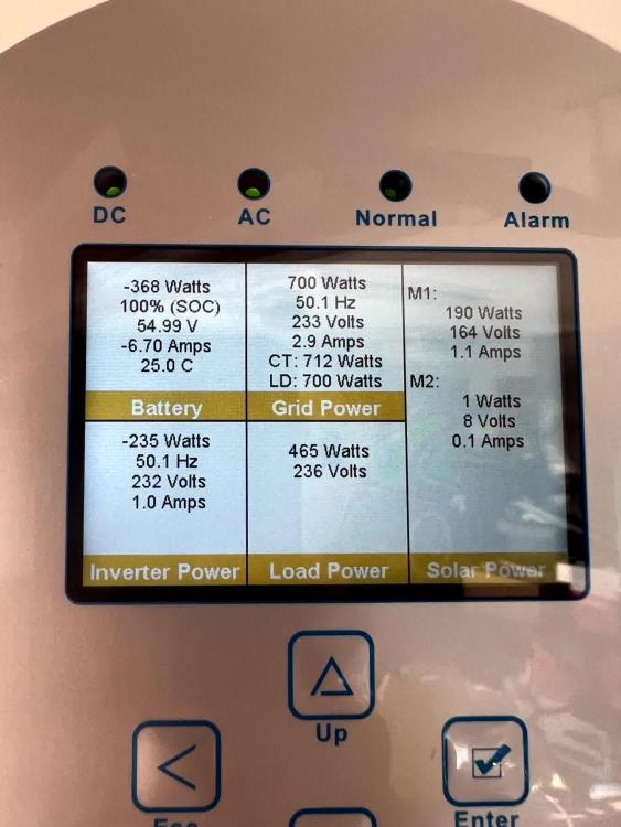

to validate that your battery is connected while using the splitter, just go on the inverter and on the settings, selectthe  icon for LIBMS(bottom right hand corner), it shows values when battery is connected.  not values when not connected.
splitter has been installed... i can see data on the esp32 logs.
the li-bat screen, well it was like this, allot of zero's to start with. and stays like that, with the yellow cable directly into the BMS port of into the splitter.
all the other screens where there is battery information mentioned is dynamically updating...
