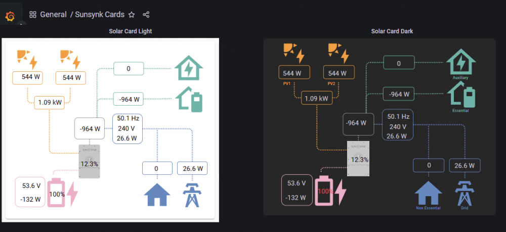

https://grafana.com/docs/grafana/next/panels-visualizations/visualizations/canvas/
system32, any chance you're good at Grafana and/or SVG...
I got a sensor that measure water level of a water tank, and would love to input a percentage full and have it visually display it in HA, minnyou I'd love to be able to show the same JoJo tank in Grafana and show / water level based on a input %.
G

On 2022/07/14 at 7:46 AM, Farcus said:
Excellent work i have my setup all have gone with Pi zero sending Data to HA on pi 4b and all looking really good.
Now with the load shedding animal i need to be able to change my charge settings on my Sunsynk Inverter similar to the settings that you can change on Solar Assistant
A lot of work that i still need to get going on grafana but i have some graphs working lekker thanks to Scoobs and Bloubul 7
I just need to figure out how i can change these settings on my inverter and if possible have the schedule changed automaticlly with these hectic schedules we have at the moment but for now if i can just change it using Home assistant or Nodered and write back to the inverter
Farcus.
I'd be keen to know how you did this on a Pi platform, I have some lying around and would love to understand/know, might be easier for me as I know them vs the ESP32 platform/builds.
please DM me.
G
