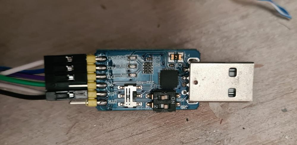

So i replaced the RS485-TTL board and made no difference...
I'm starting to worry that things may be broken on the inverter side... Is this possible?
Yes it is possible. Unlikely but still possible. Replace the ESP32 and the cable too.

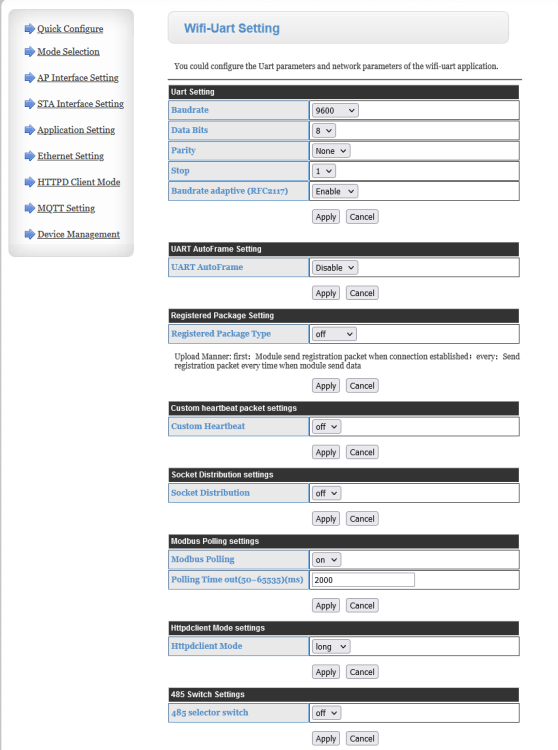

Hi,
I have problems reading data from a Deye SUN-15K-SG01HP3-EU using a waveshare RS485 <-> TCP RTU Adapter https://eckstein-shop.de/WaveShare-Rail-Mount-Serial-Server-RS485-to-WIFI-Ethernet-Module-Modbus-MQTT-Gateway?gad_source=5
I can connect to it but it always returns either "Wrong CRC for frame: 1,3,0,0,255" or "Request timed out" or "Client in error state".
Maybe I did not set up the settings correctly?
image.thumb.png.19b30f6eb8a58aba44acd87e58ba385c.pngimage.png.dc485c46edf972249f9d0e475afca120.png
My Modbus settings are
MQTT does not work either, it just shows no effect. I can see the RX Lamp blinking though on my waveshare...
Anyone any ideas what could be the problem? Are these settings correct and it is an hardware issue?
Thanks for any suggestions.

I got bought another esp32 but that one's wifi was bonkers... so waiting for Micro Robotics to check it...
Meantime I have an esp32 Cam which i might give a shot.
As for splitting the canbus... I am using canbus between inverter and battery... then rs485 between the batteries.  But splitting that guy sounds complicated... I do hope it doesn't come to that.
You can measure with a multimeter between pin 3 and 1... and 2 and 3... they should measure 4V and 1V more or less from the inverter. Pin 3 is ground and 1,2 the rx/tx lines
So pin 2/3 gives me +-4.5v and pin 1/3 gives me +-0.01v (I don't have the best multimeter ever)

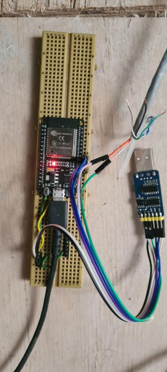

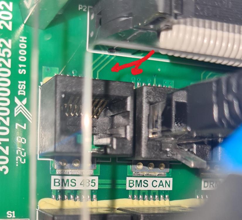

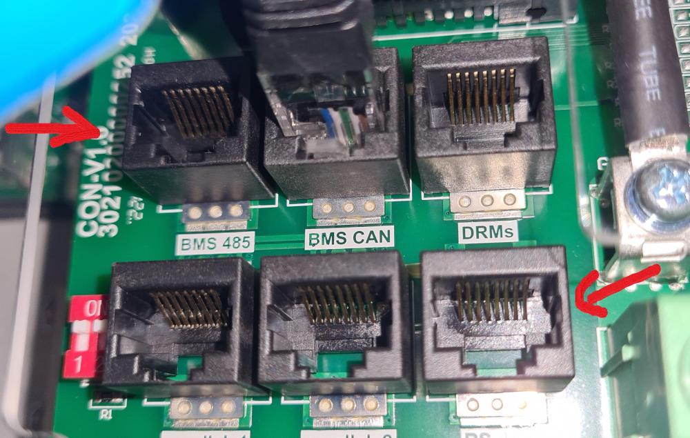

Hi.
I wonder if you could give a second, third or 4th eye to what I have done for pulling my DEYE data with ESPhome. I have tried for a week now to pull data from it into the ESPhome without success. I went over all the pages on this thread (and some others) and I extracted good ideas to try out, but without luck.
My setup:
Single DEYE SUN-5K-SG03LP1-EU with a single 5KW pylontech battery. Inverter has Solarman adapter (I'm pulling data from it into to Home assistant with the HACS integration)
Since I want to control it from Home Assistant, I'm trying to connect it with the RS485, as done in these cases:
https://github.com/klatremis/esphome-for-deye
https://www.youtube.com/watch?v=odajXzCnIpE&t=1s
https://www.youtube.com/watch?v=89Yne9QNv0w
I have an ESP32dev with a TTL-RS485 (CP2102 USB-UART 6 in 1, https://es.aliexpress.com/item/1005004948562313.html). See photos below of the connections (not intendeed to be the final implementation :) )
ESPhome is installed and yaml file is placed and running (I attach the file I used and the logs from ESPhome)
On home assistant all entities are enabled, but with unknown value. I believe the problem is between the RS485 and the inverter given the logs I get from the ESPhome (attached)
I'm running out of ideas about what to do. On YAML file I mostly tried different values for the modbus_controller address: 1, 0x1, 0x01. But all the rest seems ok

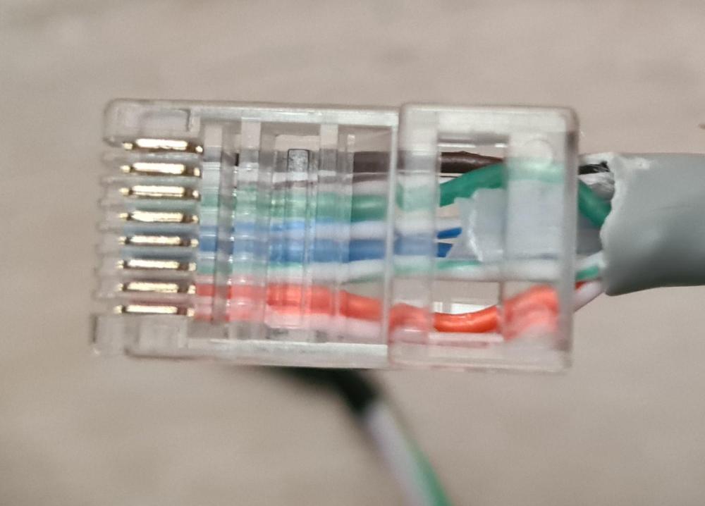

For LAN connector I tried using pin 1 and 2, or 7 and 8, or 6 (ground) 7 8 (polarity is correct). Last I tried 1/8 (B) and 2/7 (A) simultaneusly. Although, given the photo from the port in the inverter it seems only pins 6 to 8 are wired in the board.
At the end of the RJ45 I measure around 3.3v between pin 7 and 8 . There is no voltage between GND (6) and B (8)
I also have doubts about the ports. I tried with the BMS 485 (top left) and the 485 (bottom right). No luck on either. The CAN 485 is used for the battery and honestly I don't dare to use it, but from the ports available and from what I have read, it shouldn't be used.
On the Inverter, the modbus is set to 01 (it was 00 originally).
I'm a little bit temped to change the TTL-RS485, however, from the logs my interpretation is that the TTL-RS485 is doing the conversion. But maybe I should try buying this one?
Any help / ideas is highly apreciated. Thanks!
