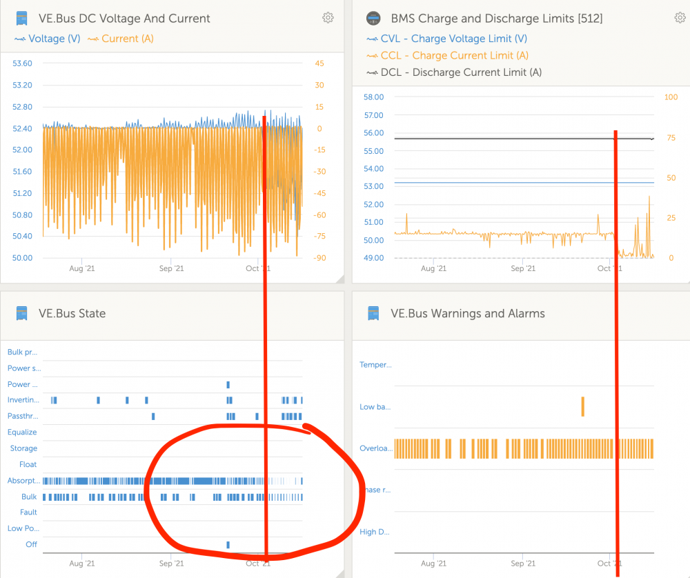

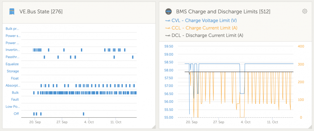

This is what my system's CCL and Bulk/Absorbtion looks like. The BMS asks mostly for a charging current above 0 Amps, in my case 250 Amps. The bulk of the time is spent in Bulk mode, no pun here..... On the Pylontech, after Firmware update, it looks like the firmware logic is inverted.... see bottom image.

Inverted logic post red line.

As per the below, the Firmware enabled the Min/Max cell voltages being sent to the GX from the BMS on 2 Oct. This indicates that the cables etc are working as it should. It is clear that the firmware are causing a lot of voltage variability as per the graphs, from 2 Oct.
