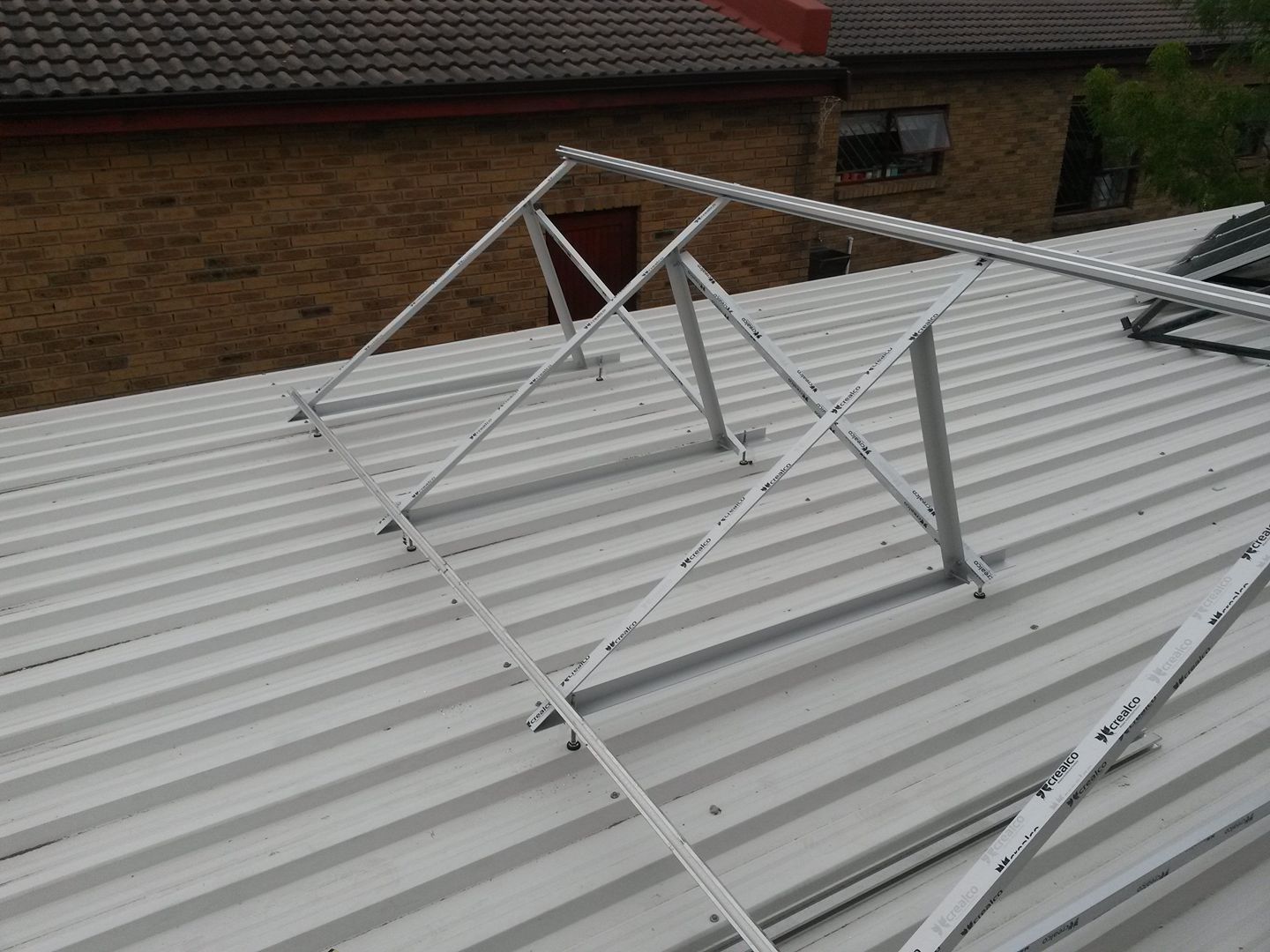

This is the last one I made, to fit 3 x 300W modules side by side. 8 Hanger bolts going into the beam below. Aluminium frame from angle-aluminium. That's just over R1000 worth of aluminium you see there. The hanger bolts was around R300. Bolted together with stainless steel bolts, and I have a aluminium rail (got it at OnTrack) on top with the standard little twist-in nuts.
I already own a mitre saw with an aluminium blade though. That makes it super quick to build things like these.

On 2018/04/10 at 9:58 AM, Wetkit said:
Ok, some foto's from another install that was done for work, using similar products.
Are the clamps on the sink roof sheeting also a cab strut product? I like what  looks like no drilling when using those clamps.
