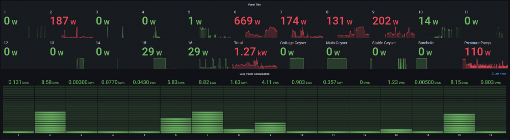

July 9, 20214 yr Author This is the panel I created in Grafana for the data, I am monitoring some eWelink breaker switches as well which also have power monitoring on them.

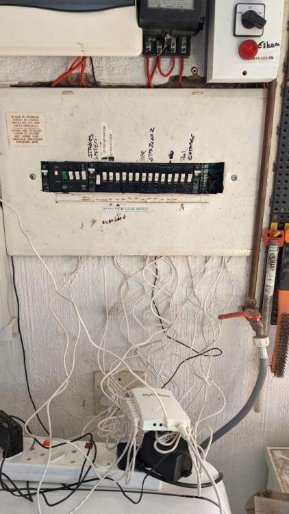

October 21, 20223 yr Jano.... your pic... I am having a hard time getting this vue to turn on... where did u connect the black..red..white..and red cable??? Have same panel as u.... Petrr
October 21, 20223 yr Black and White connected to the DB. Will look for the manual now for reference.
October 21, 20223 yr From the manual Quote Insert the power supply wiring harness into the bottom of the energy monitor until it clicks into place securely. The wire harness allows for single-phase power and three-phase voltage sensing: White connects to Neutral, Black provides power and voltage sensing, and Blue and Red enable voltage sensing only
October 22, 20223 yr I am from Canada and know North American panels... currently I am at our house in South Africa and the db board/panel is diffrent... just looking to see exactly here I connect these wires on the db...maybe with a pic? lol
