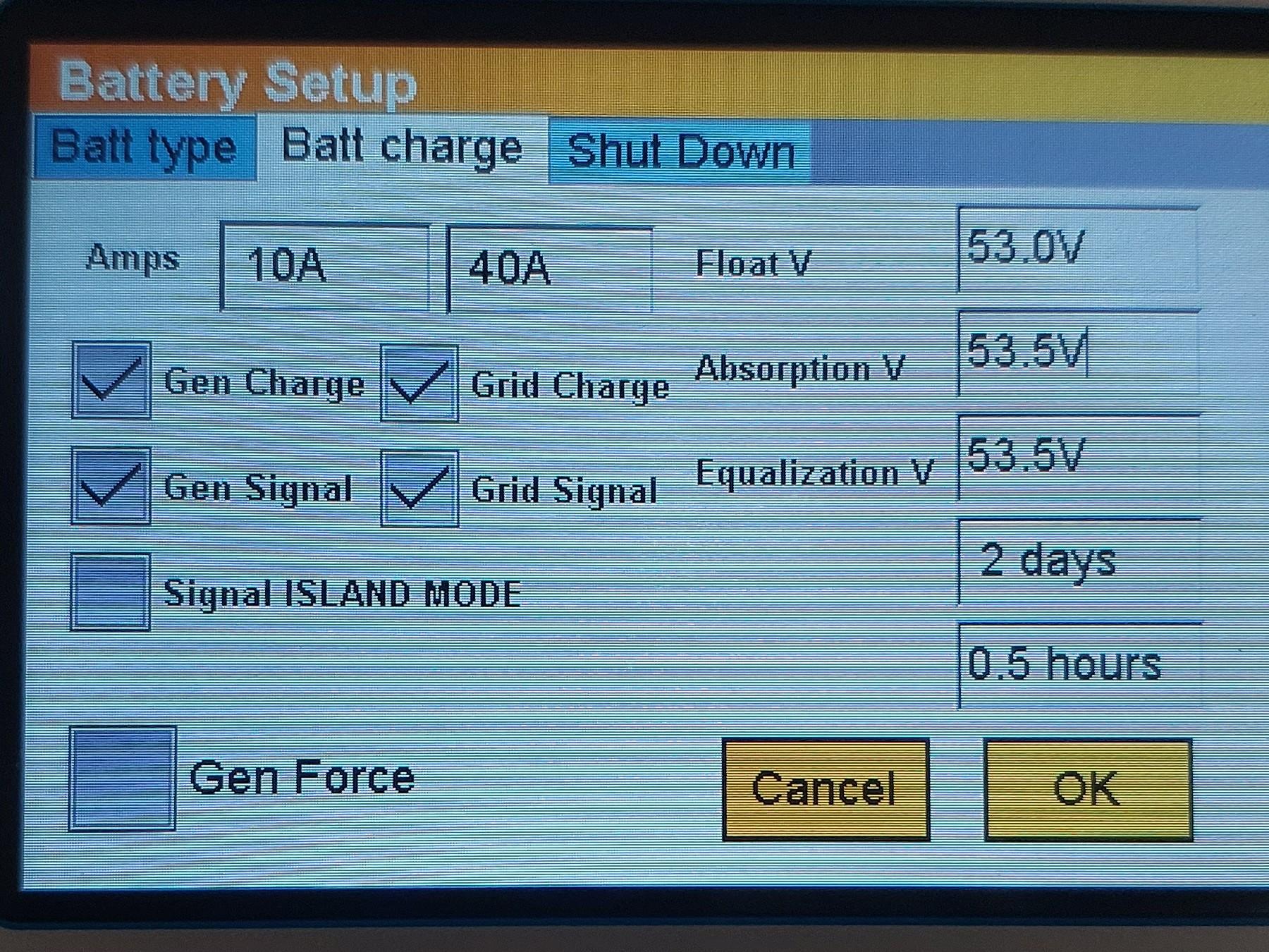

July 1, 20214 yr Hi Guys I have recently had a 5KW Sunsynk Hybrid installed with 2 x Pylon US3000C batteries. The system is operating flawlessly, except for some reason, the Inverter/BMS will not allow me to set a DOD lower than 35% ? whereas it should be able to go to 95% ? Any ideas? Thanks LD
July 1, 20214 yr 10 minutes ago, lyndiesel said: Hi Guys I have recently had a 5KW Sunsynk Hybrid installed with 2 x Pylon US3000C batteries. The system is operating flawlessly, except for some reason, the Inverter/BMS will not allow me to set a DOD lower than 35% ? whereas it should be able to go to 95% ? Any ideas? Thanks LD There's another screen under battery setting where you need to set the minimum SOC. The time of use settings will only allow you to set it up to the amount specified under battery setting.
July 1, 20214 yr Thanks Achmat for this info. I will check when I am home again. I think on this screen it also wont allow a lower setting than the 35%, but I will check and let you know if it worked. Regards
July 1, 20214 yr I had this same issue , after a firmware upgrade i could then set it all the way down.
July 2, 20214 yr Thanks Achmat & Nexuss for your replies. I managed to increase the DOD setting through one of the battery setting screens. Its not that clear in the manual. The page that allows a lower setting, at first glance looks as if it only pertains to other batteries like AGM and not Lithium...so it pretty much got over-looked by me! Regards
