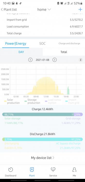

Buyeye Posted July 27, 2021 Share Posted July 27, 2021 2 hours ago, Justipoohs said: That's my point surely "going solar" is the perfect moment to re evaluate usesge. @Justipoohs embracing the offgrid lifestyle is a term I often use but I actually bought my aircons after installing my inverter and 6 panels and 4 lead acid batteries. On most sunny days 6 panels actually produces a lot of electricity as you can see on my screen shot. On cloudy days you won't need the aircon as much. I was running a 18000btu aircon in summer on 6 panels and the wife was very happy. What I'm trying to say is since you already have 4 panels another 4 might just be the trick to cool summers in the karoo. A 12000btu inverter aircon would probably peak at 1200watts. The fine lines are the aircon going on and off, without the aircon my loads were also 400-600 which meant 6 panels was already overkill. hoohloc 1 Quote Link to comment Share on other sites More sharing options...

Justipoohs Posted July 27, 2021 Author Share Posted July 27, 2021 5 hours ago, Buyeye said: @Justipoohs embracing the offgrid lifestyle is a term I often use but I actually bought my aircons after installing my inverter and 6 panels and 4 lead acid batteries. On most sunny days 6 panels actually produces a lot of electricity as you can see on my screen shot. On cloudy days you won't need the aircon as much. I was running a 18000btu aircon in summer on 6 panels and the wife was very happy. What I'm trying to say is since you already have 4 panels another 4 might just be the trick to cool summers in the karoo. A 12000btu inverter aircon would probably peak at 1200watts. The fine lines are the aircon going on and off, without the aircon my loads were also 400-600 which meant 6 panels was already overkill. The problem is here, outside Upington the cooling, in our case evaporator is needed more through the night in order to sleep so aircon isn't really an option without a 200k solar system. Quote Link to comment Share on other sites More sharing options...
