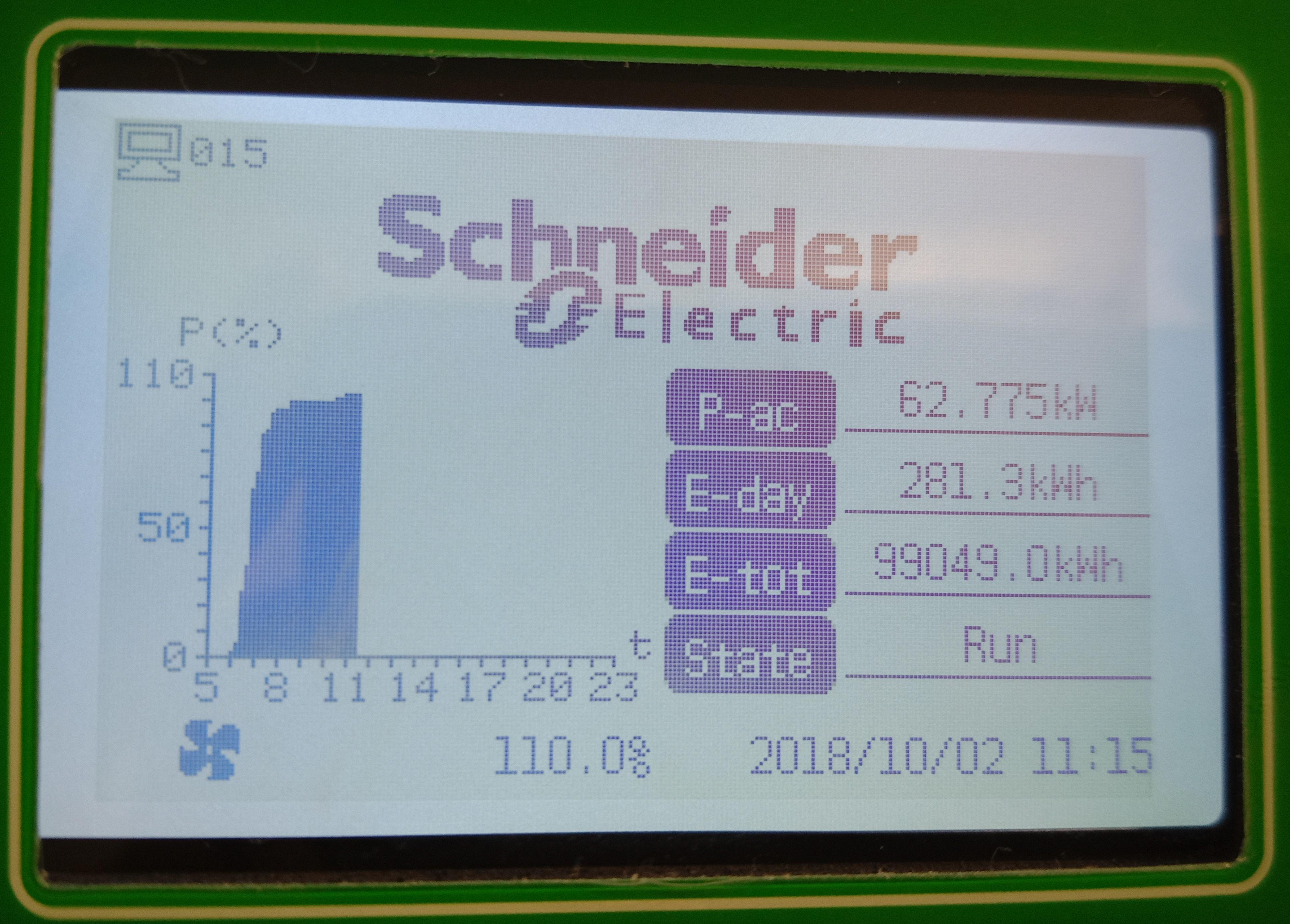

September 21, 20214 yr Author 10 hours ago, Gerrie said: Very interesting stuff, just out of interest was there any favorite between the four? The SolarEdge is a nice piece of kit but too sophisticated for Zim, the power quality thresholds are too tight and so it's the first to cut out and the last to start generating. Of the two inverters we put in, one had to be replaced after a year, under warranty. Of the 110 optimisers, about 6 have failed since install 3.5yr ago. ABB - a nice machine, a bit of a mission to commission but no issues with it since up and running. Looks like it has the lowest efficiency of the bunch but probably by less than 1%. Delta - sounds like a helicopter with those fans, but a good machine. Schneider - I think this is just a rebranded sungrow. Our pick of the bunch, nice piece of kit, this and the delta have the best kWh/kWp production, best conversion efficiency. Very robust and can handle wide grid power quality parameters.

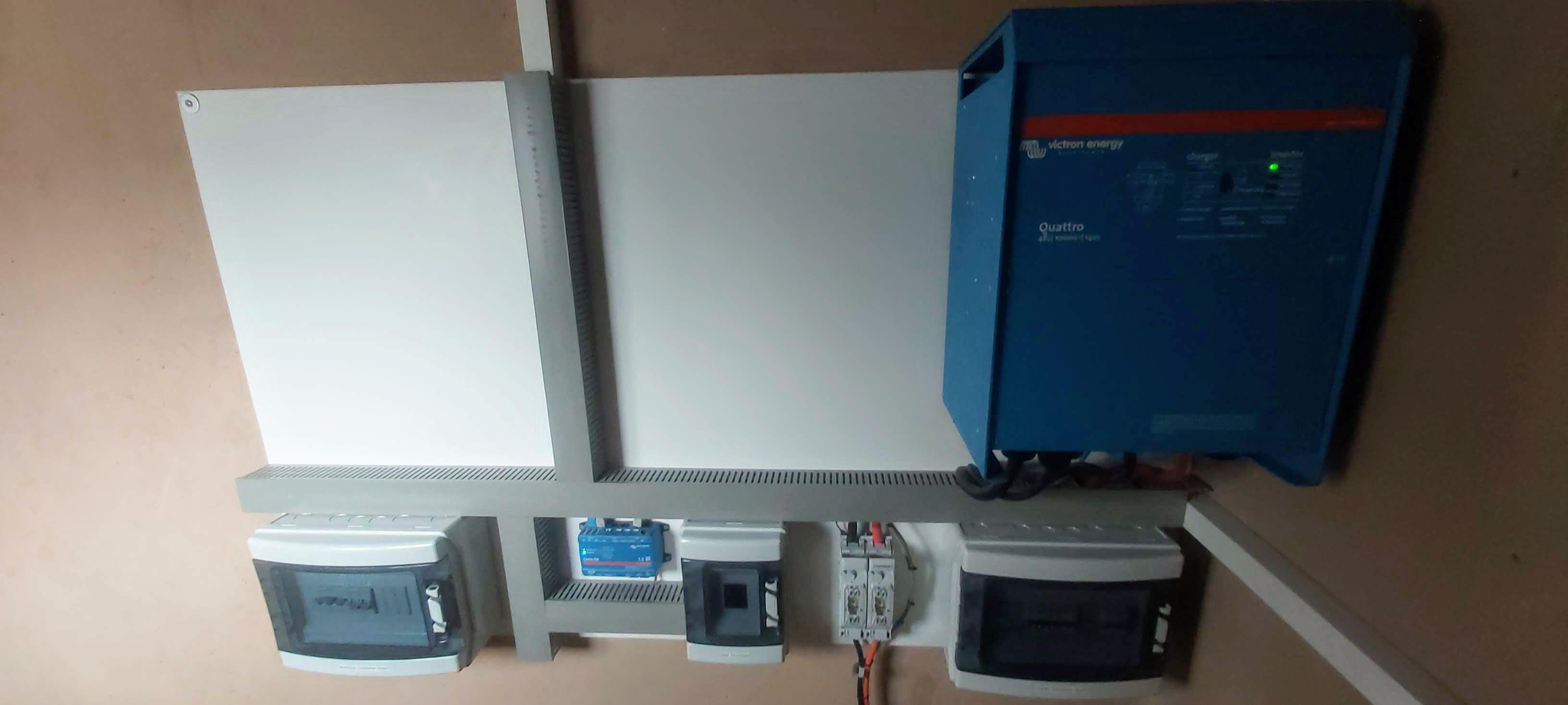

September 21, 20214 yr Author 18 hours ago, 87 Dream said: Great project, welcome to the forum!!! Keep us updated, we are suckers for Solar Porn pics 🤣🤣 87 The installation is planned for Monday. Parts are going together, leaving space for the future MPPTs...
September 21, 20214 yr That should be a picnic to wire up 🤣. Just noticing the picnic tables in the background...
September 30, 20214 yr Author So this baby is in and performing, quite sad without the MPPTs tbh, could be doing so much more than just waiting for a power cut 😆

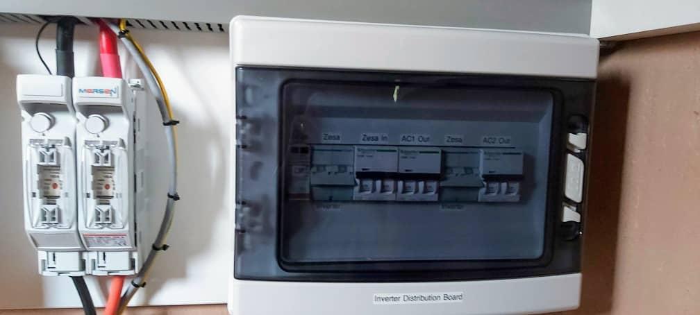

September 30, 20214 yr Author One DB is all inverter based, grid supply on/off, changeover switch for AC1 out and changeover switch for AC2 out. The other AC DB is to supply loads that are no longer fed from the main house DB: Garage, Cottage and Verandah.
September 30, 20214 yr Author Everything except for geyser element (on AC2 out) is on the essential loads AC1 out. Even without scheduling what goes on/off this 10kVA setup seems more than sufficient for the current needs. At this point in the house we have no idea when the grid is available or not 😄 We use kettle, coffee machine, hairdryer, borehole pump, washing machine all at will, on a whim.
December 16, 20214 yr Author Ahhhhh now that's better!! Added 20x CS 325W panels (5S 4P) 6.5kWp MPPT 250/100
December 16, 20214 yr Author Left space on the board for future MPPT in case I want to add panels and double batt to 28kWh. Now to tinker and try maximise solar usage, I'm not feeding into the grid at this point.
