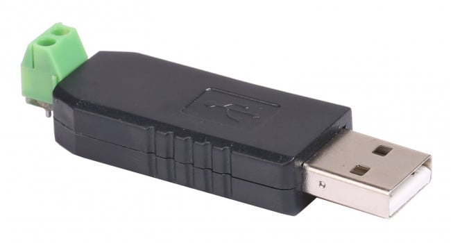

But i get no communication to home assistant via the rs485-usb converter.

Your usb converter is almost certainly not mounted at /dev/ttyS0; it should be /dev/ttyUSB0 (or more).
It might be that the usb converter is not picked up, or the config is incorrect. If you look at:
https://github.com/kellerza/sunsynk/blob/main/hass-addon-mbusd/config.yaml
You will see it pointing to /dev/ttyUSB0.
If you don't have /dev/ttyUSB0 then your USB converter is not being picked up correctly.

On Ubuntu terminal I do get /dev/ttyUSB0
Found the problem - I am running home assistant on an ubuntu server under virtualbox.
You need to enable usb under virtualbox otherwise no usb device will be seen in Home Assistant

I'm having the same issues with my DEYE 8kw inverter. I eventually just gave up. Pretty much getting the same as what you are getting above.
I get this 1st as per below.
"No response on the Modbus interface, try checking the wiring to the Inverter, the USB-to-RS485 converter, etc"
and then i sometimes get the below with my inverter serial number
Inverter serial number '2315xxxxxx'
I wonder if this info below would make any difference? I don't know anything about the coding or if it is even relevant to the code, but they are saying there are differences between the 5KW and the 8KW. maybe the code has to read each one differently????? Who knows. I have an 8KW inverter.
"Another confusion is that the 5.5kw and the 8.8kw does not use the same markings for connecting up the GEN/GRID/LOAD."

Dongle that I use: https://www.robotics.org.za/W17286
Modbus Log when rs485 dongle is removed from RPi4 USB:
15 Sep 2022 09:34:46 tty: trying to open /dev/ttyUSB0 (speed 9600 mode 8N1)
15 Sep 2022 09:34:46 tty_reopen(): can't open tty device /dev/ttyUSB0 (No such file or directory)
Modbus Log when rs485 dongle is present  in the RPi4 USB:
09:42:48] INFO: Starting mbusd -d -L - -v 2 -p /dev/ttyUSB0 -s 9600 -m 8N1 -P 502
15 Sep 2022 09:42:49 mbusd-0.5.1 started...
15 Sep 2022 09:42:49 tty: trying to open /dev/ttyUSB0 (speed 9600 mode 8N1)
So it looks like the USB is "seen" by the RPi4 HA (running in a docker) ?
Thank you P1000
I now sit with another problem... When I go into Terminal (HA) and type login, it prompts me for a login and password!!! I have not seen this before. What do I do now? Any idea?
Not to worry.... I came right. It's working now, but get lots of timeouts?
