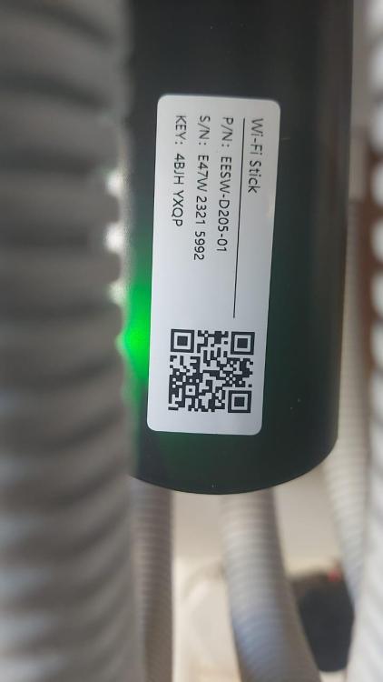

August 7, 20232 yr guys, I'm helping friend that recently had a 5Kva Sunsync installed. He's got the dongle as per image installed, I've installed the integration (region 2)... but getting no data really out. (https://github.com/spotityza/Home-Assistant---E-Linter-Logger---Sunsynk) On the PlantID debug output I only get state: 257083 Below is also a screenshot from the on Android app installed/given to him by the installer. The Login tab seems to imply success logging in. G Edited August 7, 20232 yr by georgelza
