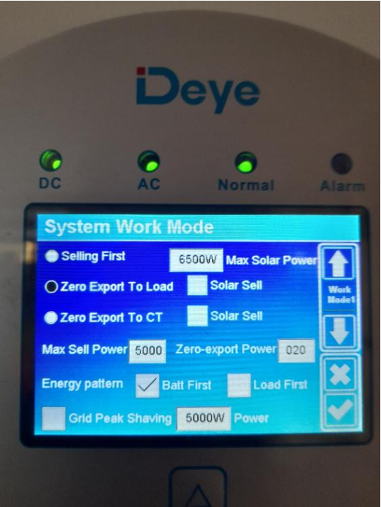

August 22, 20224 yr Hey there im new ive got the sun 5k-sg01/02lp1-eu deye hybrid inverter. Im not sure how to get the most out of my system in these pics is my settings please advise me if some setting is wrong please. Im from south africa gauteng. i have a few more pics but i can only send so much. I dont know if my settings is correct or not???

August 25, 20224 yr The settings look good, personally I prefer to power the loads first from PV, it is more efficient. Battery can be charge from any excess You did not state what your aim is for the system and what problems you are experiencing so nobody knows how to answer your questions.

August 25, 20224 yr 35 minutes ago, Nicolette said: No problems really im just using the same amount of prepaid electricity. Shouldnt u use solar in the day? But if i go check it shows the grid is proveding more than the solar. please post picture of system work mode 2. You said you have 12 panels, what is the wattage of the panels? Edited August 25, 20224 yr by phidz added panels
August 25, 20224 yr Instead of Zero export to load being ticked, should that not be Zero export to CT?
August 25, 20224 yr 6 hours ago, Nicolette said: Please exlain how i can do what u said. If u can send me a pic where i can change it thank you. If I may, looking at your own photo, on this page, System Work mode, as said by others, suggestion is to tick "Zero Export to CT" in the left middle of the screen, as well as the Energy Pattern of "Load First" on the lower right side of the same screen. For the battery settings, shown below, try to un-tick the box for charging from grid. The point would be to try and charge your battery using the available solar power, not to keep it charged via Eskom. You could later play around with the time-of-use settings to do a grid-charge once a day, eg. maybe near the end of the day for topping up if it was a cloudy day. Bear in mind that for your battery the recommended charge/discharge rate is 50A, and maximum at 100A. Although you could cap it at 95A, it is probably better to keep closer to the recommended value most of the time rather than near the peak.
