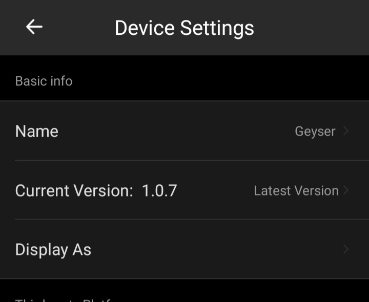

1 hour ago, Petum said:
Hey there.
Please let me know how you get the consumption of your geyser to show on the main page?
Mine only shows if you select the device.
Cheers

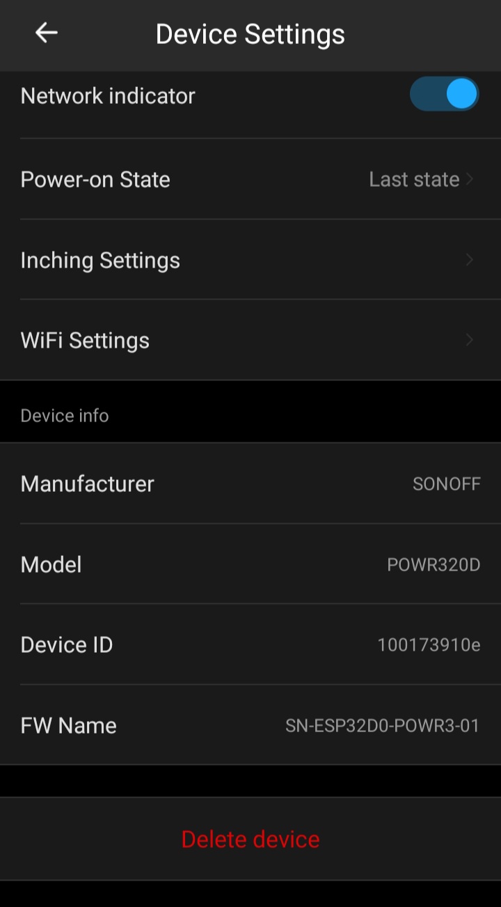

Hi How are you?
Which device do you have?
It happens automatically,I see that all the POWR320D and the  POWR316x all display and the POWR2 does not. I do belive that all the newer devices display.
3 hours ago, Petum said:
Hey there.
Cheers
Compare these perhaps there is a hardware, firmware or software difference.
Have one of these guys.
But now seems to have given the ghost.  Still measures draw but doesn't turn on and off.
Gona replace, was thinking of a cbi asc? This is for the whole house.
I'm getting the hang of HA so display on ewelink home page isn't really important.
Any better options/recommendations?
