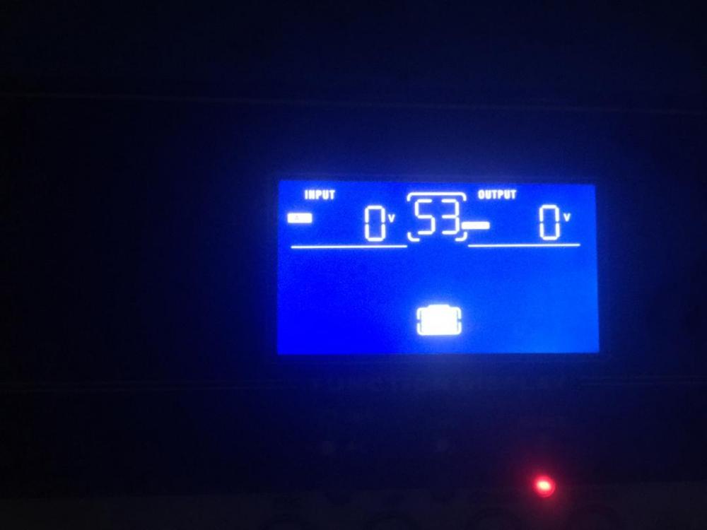

Error 53 on inverter
Its a new inverter, when i switch it on if fails to close the link which show it’s now on and the output ranges from 7~9v
Battery is on 50.2vdc, No PV connected at the moment.
Kindly assist what could be the problem
Its a new inverter,
On an Axpert inverter, this is "inverter soft start error". I believe what happens is that after the bus has charged up, the next test is to run the inverter at a low PWM (that's possibly the few volts you saw), and wait for a zero crossing of the inverter output. My guess is that either the output relay failed to close, or there is a fault with the full bridge inverter IGBTs or their gate drivers.
Do you have any loads connected? If so, try disconnecting all AC loads.
If not, then since this is a new inverter, this is definitely a fault, and you should get it replaced or repaired by your supplier.
This appears to be a clone that I'm not familiar with, so it's possible that error 53 has another meaning, but it seems to fit your symptoms.
