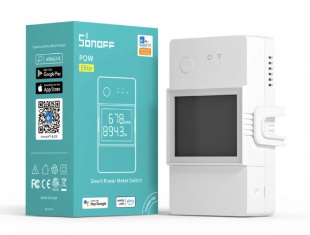

November 15, 20223 yr Hi @Sonoff Africa Are you aware of any connectivity issues with the new Powr320d? I have two switches in different locations that regularly go offline. I updated to the latest firmware and are running 1.0.7 as off yesterday but both were offline again this morning, they were previously running 1.0.6. If you switch the switches off and then on again and they connect to the wifi and usually work for +- 24hrs before they go offline again. One is located almost directly next to a wifi AP and there is a PSF-B67-GL switch running next to it with no issue so don't think it is a wifi issue

January 16, 20233 yr On 2023/01/14 at 10:31 PM, abd7 said: https://sonoff.tech/product/diy-smart-switches/pow-elite/ As per their website the POWR316D & POWR320D support IEEE 802.11 b/g/n 2.4GHz So one shouldnt need to switch to legacy for these products. Perhaps it was a last resort from sonoff support to try to get it to work? Hi How are you? That is 100% correct. With the newer units no need for legacy Aleks
January 16, 20233 yr On 2023/01/14 at 4:12 PM, Sc00bs said: Hi Aleks Tried giving them fixed IP adresses but doesn't seem to make any difference. I have noticed that they see, to loose the connection if I have power loss for some reason. When the power comes back on they just don't connect, or give up trying to connect before my access points have connected. I have a TP-Link mesh running Wifi6 Access points so there should not be any issues. If I switch the power for the Power320 Sonoff switches off and then back on again, it connects without any issue and will stay connected. Any other ideas, if I could delay the boot up off thew switch by 2 minutes to give the AP time to boot up and connect I am sure that there would be no issue. Hi I agree, if they were delayed start would resolve the issues. One fix is to have the main router and mash on small backup power so they don’t go offline. The other issue we have seen is Double NAT issues. The fix is to have the mash in bridge mode and IP's reserved on the main router. Only one subnet on the network. Hope that helps Aleks

May 11, 20233 yr I'm replacing this switch with a Tuya one, I can't be getting up everytime after load shedding to reboot this switch, just to make sure I have hot water in the morning. It's silly that they broke something that worked just fine with a software update, then they do absolutely nothing to fix it, and offer no way of reverting. My wifi stays on through load shedding, I don't see why the POWR320D can't just get power and connect to WiFi like everything else. All my other Sonoff devices connect just fine, and reconnect if they ever lose Internet.

June 3, 20233 yr I have just installed the Power320d and I'm having the same problems. After 24hrs it just won't connect again without me physically repairing it. Also my WiFi never goes down during loadshedding as it's on back up power. I have several other sonoff devices, but all reconnect seamlessly after loadshedding ends. Evidently there is something wrong with the software and a bug of sorts in the programming.
