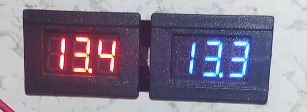

Without a battery balancer I would use 2 small voltmeters connected to each battery so there is a visual indication if they go out of balance to top up the lower one. I just switch my inverter off when I give 1 battery a bit of charge to balance. No need to even disconnect any lead. At times mine will differ 0.1V and while using them they get to the same voltage again. If the difference remains then I do charge the lower one. My S-100s are now in use for a year. Current no load level after heating my geyser via heat pump due to LS in the picture below.

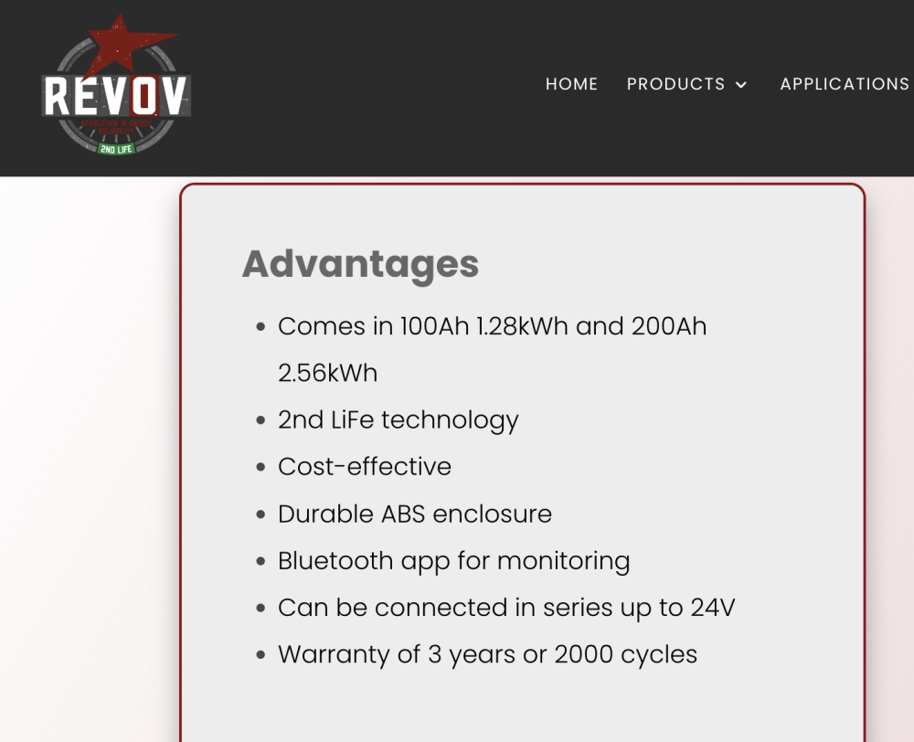

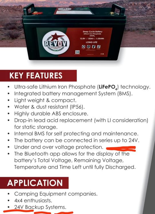

If its these https://revov.co.za/products/life/revov-12v/
Interestingly it does say for 12/24v chargers though. I can't see how that will work without communication between them.
interesting if you read this last sentence here;

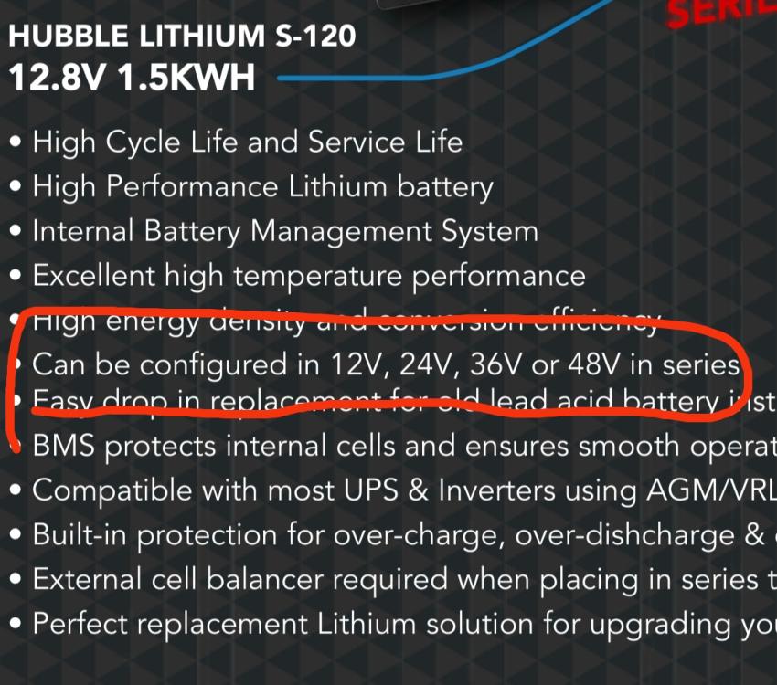

Very simple. Each battery has its own BMS for balancing between cells. A battery balancer is used to balance up to 4 batteries in series.
What else must you balance?
Why do you say in this case you cannot series if the manufacturer says it's OK?
That's for Hubble batteries not the OP's batteries!
On the manufactures web site I can't see any mention of a battery balancer or in any instructions. If they recommend them for series they should point out that other external equipment is required.
The OP doesn't have a balancer and the batteries are not getting to 100%. It's not working.

They say they can be connected in series up to 24v. Let me contact them and ask
That says 2nd life batteries, I thought yours were the 1st life. Which are yours exactly?
FWIW the same applies for their new cells. Choose as you wish between new or 2nd life. You are welcome to confirm it with Revov if you won't accept it from forum members showing their replies and info on their Web
