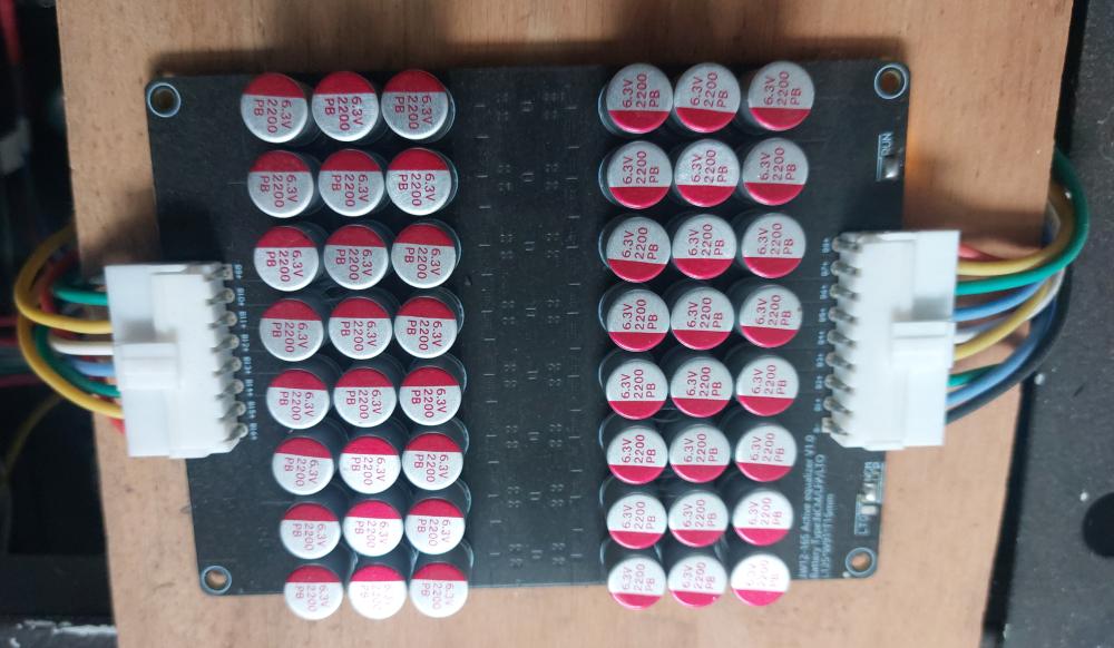

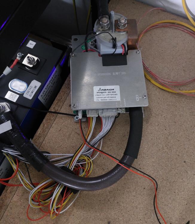

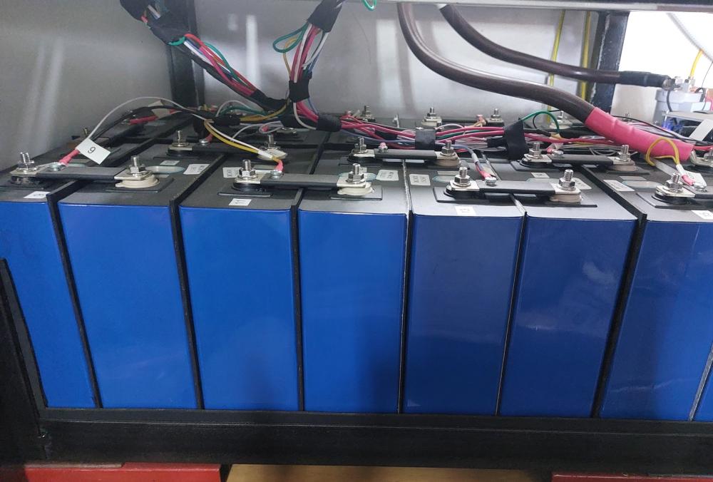

Just experiences from buibuing , I have a 272amp back build in 2021 its over a year performance is fantastic i get at least 14kwh from the pack. Charge voltage is 55v, charge current 100amp, discharge is 100amp aswell ,cut off 50volts, JBD bms with SA. Lishen 272ah cell from Basen Technologies, JBD bms from AliExpress and Active Balancer from Hankzor AliExpress.
