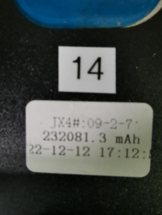

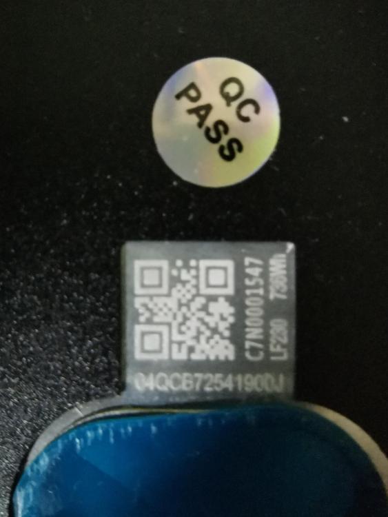

Please let us know how this goes, the pictures show cells without any barcodes. Also no business address and only taking EFT, and the website does not even use TLS.  They only have 34 cells in stock which makes them seem more legit.
When I bough my cells LBSA had 3500 second life cells in stock, when I bough mine they were down to 1800 cells. The whole batch sold out in under 3 months. Eskom is creating the perfect storm
A reputable member from a 4x4 forum bought 16x 230ah cells from them. He traveled from KZN to their premises (can't remember if it was Benoni or Boksburg) to ensure he's dealing with legitimate business and he shared his built journey with us and he is happy so far. Currently they are out of stock of 230Ah cells (stock expected in January) and limited cells of 120Ah. It seems like the company is run by two young brothers, I've chatted to one of them before placing my order today, friendly and knowledgeable.
Disclaimer: I have no affiliations to this company, it remains the responsibility of each potential buyer to do their own due diligence before buying.
That being said, I think we should give them a chance just like we did with LBSA.

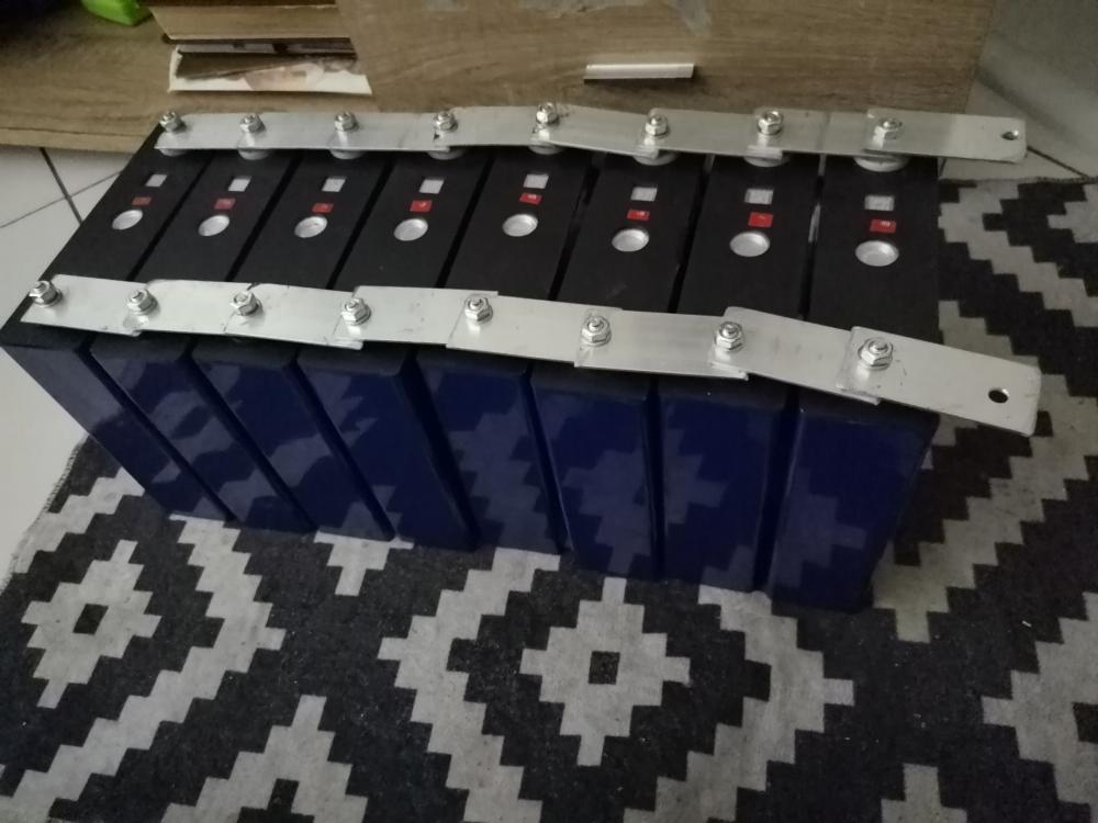

I just received my cells today, made bus bars and ready to top balance them when Eskom is back. IMG_20221216_213201.thumb.jpg.8515cade4149db729bf948eef04497ef.jpg

Don't connect the bus bars that way you must maximise contact, no angled contacts, bar to cell 1, cell 3 and over them on cell 2, 4.
The cells come at around 30% soc - so now you have a 3.2 V 1840 Ah battery - so you need to charge it with around 1288 AH. So if you have a 10 A charger it will take around 5 days  with no BMS protection so you have to be there all the time . BEst to wire it up as an 8S battery , charge it with BMS . Moderns BMS's now have high balancing current so usually no need to parallel up , let BMS do the balancing - starts at say 3.4 V/cell , then 3.45V - 3.50V . No need to go over 3.5
Thanks, I made these bus bars in hurry chasing loadshedding but I'll correct them before final assembly.

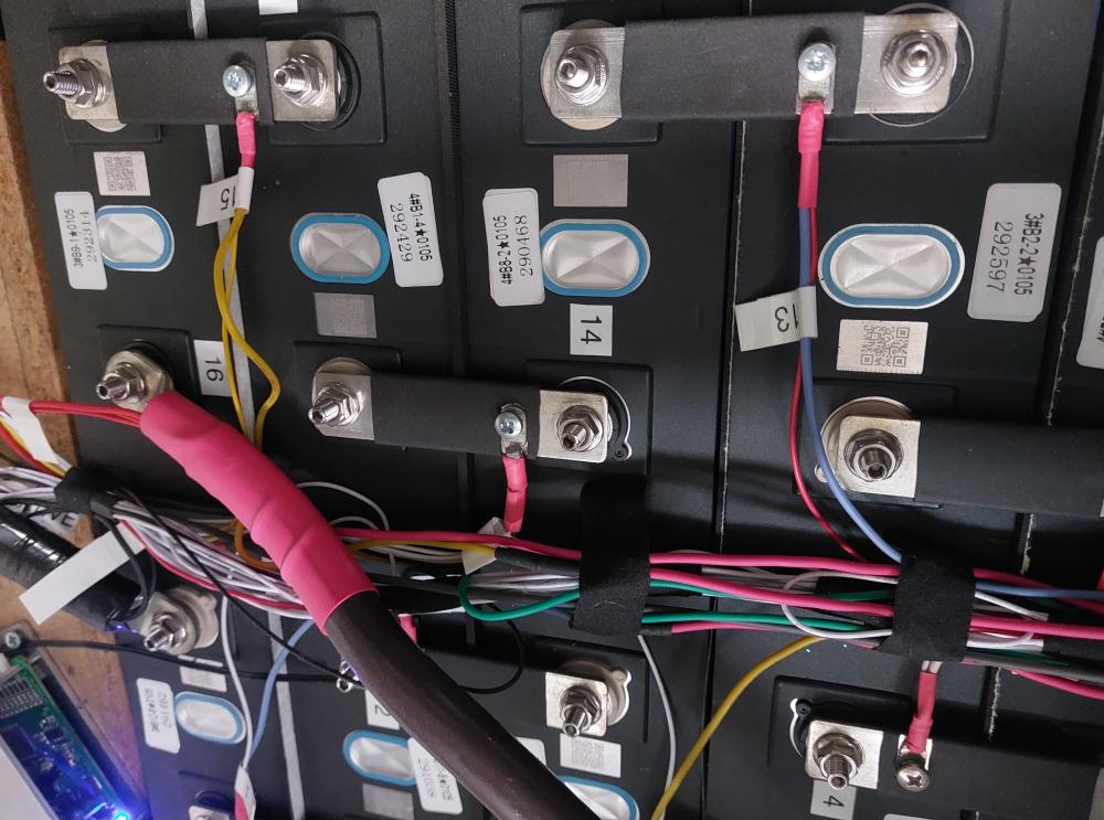

A few months ago I bought 4 x 3.2 volt 100 Ahr cells (new) from a company called Cinch-IT in the Cape. 12 volt BMS (excluding temperature sensor) was bought on a special from a supplier advertising on BidorBuy.
I also purchased 4 x 3.2 volt 50 Ahr cells (2nd life) from Electromann as I had already purchased a 12 volt 55 Ahr BMS (with temperature sensor) from them a year or so earlier. Must say that these cells looked the worse for wear but so far have behaved faultlessly.
Aluminium flat bar were used for the links/busbars. A2 stainless steel hardware was used throughout. Purchased a battery box ex. Electromann for the 100 Ahr pack and used an off-the-shelf ABS electrical box which I modified to suit the 55 Ahr pack.

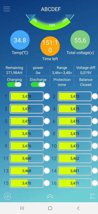

Various blogs stated that all the cells should be brought up to the same state of charge using numerous methods. I chose to charge up each cell separately (bit laborious) with a dedicated single cell charger (bought cheap ex. Battery Experts) prior to coupling everything up.
Was it worth it? Depends primarily on the price and quality of the cells. Also, good quality BMS's are not cheap. In addition, don't expect much in the way of component guarantees if it is a DIY project. If you make a stuff-up you could be left with an expensive paperweight at best - or potentially cause real harm to oneself. Safety first!
All in all I saved around R3000 on the 100 Ahr build and close to R2000 on the 50 Ahr build (excluding my time) when comparing them to middle of the range batteries. Obviously not talking Blue Nova prices here!
