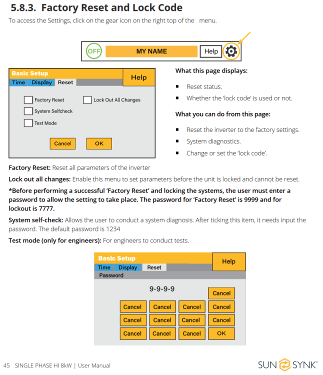

Have you tried a factory reset ? Your system mode times should be set to the default so that the first time starts at 1am and the last timeslot ends at like 9-11pm+-,they have to follow each other. I have seen issues if they dont follow each other like this. Most of your settings look pretty good. After a factory reset try changing just the SOC parameters in the work mode and see if it will save that .
