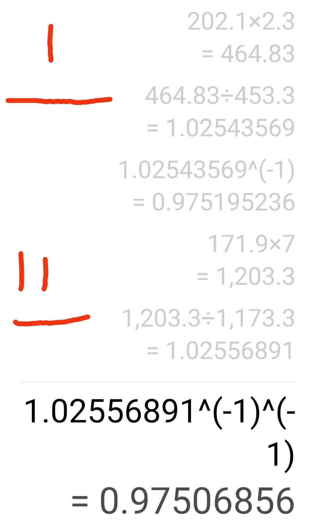

Over 95% ?  I simply don't buy that.  Properly designed inverters will be typically 90 to 93%.  It will most likely need very exotic components to reach 95%
You don't have to agree but here are 2 loadings yesterday using the actual data points for input from PV and 230V output from the MPPT. Both over 97%.
Loading of 29 and 75% of the inverter output. Voltage and current readings shown on DC side and Watts output on AC side.
