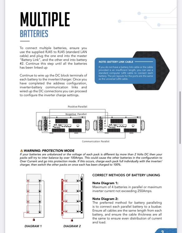

P1000 Posted September 19, 2023 Share Posted September 19, 2023 This is what he said about daisy chaining. Battery one connects to inverter via positive then daisy connects to batt 2 via DC Pos Neg then batt 2 goes neg to inverter Hope that Makes sence. Yeah, that's nonsense. What I think they mean is that positive from one battery and negative from the other (to the inverter). But that is clearly not relevant according to the logs. Quote Link to comment Share on other sites More sharing options...
P1000 Posted September 19, 2023 Share Posted September 19, 2023 That battery was in a VERY bad state . By the looks of it they dont have the BMS configured correctly at all or the cells they are using are just bad and not IR matched. Cell 1 going both OV and UV means that it is buggered. You can't balance that out. Quote Link to comment Share on other sites More sharing options...
Steve87 Posted September 19, 2023 Share Posted September 19, 2023 Battery one connects to inverter via positive then daisy connects to batt 2 via DC Pos Neg then batt 2 goes neg to inverter Hope that Makes sence. Ok that makes sense, but how is it wired to the inverter? Like how he says or does it go Batt 1 + & - to inverter then Batt 2 connects to Batt 1?? Quote Link to comment Share on other sites More sharing options...

Leshen Posted September 19, 2023 Share Posted September 19, 2023 Ok that makes sense, but how is it wired to the inverter? Like how he says or does it go Batt 1 + & - to inverter then Batt 2 connects to Batt 1?? It’s connected as in Diagram 1 Steve87 1 Quote Link to comment Share on other sites More sharing options...

Leshen Posted September 19, 2023 Share Posted September 19, 2023 It’s connected as in Diagram 1 Is Diagram 1 daisy chained? Quote Link to comment Share on other sites More sharing options...
Steve87 Posted September 19, 2023 Share Posted September 19, 2023 If you have connected them as the diagram then absolutely no issues at all. The guys at Hubble trying to discredit you & the Install to refute the warranty. Bottom line they need to replace the cells & then get the battery back in service. In my opinion they can't choose who they deal with. PV green card or not, you are a customer the same as your client we are here to uphold standards in an installation that is all you are doing. The battery has a weak point they need to repair that week point as they are the OEM. If they need you to be PV Green card accredited they need to provide you the warranty document that states that & also that a customer needs this for any claim. It's absolutely rubbish. I'm in for the fight with such crappy suppliers. They must wake up or ship out... hoohloc, WannabeSolarSparky and Jacques Ester 3 Quote Link to comment Share on other sites More sharing options...
Steve87 Posted September 19, 2023 Share Posted September 19, 2023 Is Diagram 1 daisy chained? Yes all the batteries share the current. No difference in diagram 1 or 2. Common + & - bus for the entire pack. Current will be shared across each battery in the group. Quote Link to comment Share on other sites More sharing options...
Leshen Posted September 19, 2023 Share Posted September 19, 2023 Yes all the batteries share the current. No difference in diagram 1 or 2. Common + & - bus for the entire pack. Current will be shared across each battery in the group. Look at this response which shows how ignorant they are. Hi Leshen Just to clarify, you have installed 2 batteries that are exposed to a cable that potentially can be energised up to 160A. You do know that each battery is only rated to a maximum charge/discharge current of 100 Amps? I have attached the BMS log as requested. I stand by my initial email that the warranty is void, once again refer to our warranty document attached, specifically item #12. You are welcome to take any measures that you see fit. Jacques Ester, Nexuss, WannabeSolarSparky and 2 others 4 1 Quote Link to comment Share on other sites More sharing options...
