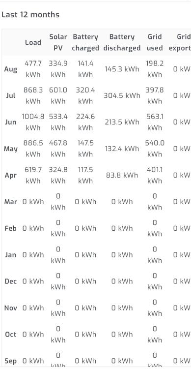

Here is readings from the inverter
I don’t unfortunately take pictures every month but I think this now will prompt that action. We can’t export to the grid in my area.
Looks like I need to and visit them as they saying estimated readings.

Your electricity reading period for Jul to Aug, as below, is over a 38-day period, not just a month, so you couldn't compare that directly to the inverter's monthly readings.
It does show a jump in daily average consumption to 34.669kWh, up from under 20kWh a month or so before. Could that be due to increased Winter consumption? Export through the meter counted as usage?
Anyway, even if the usage is correct, it's clear here that you didn't get the benefit of the inclining block tariff re-setting to Step1 at the end of the month. They kept on billing the extra days at Step2 and even Step3 rates within the 38-day period. You could try to argue that down.
There may be more issues at play, but that's the most obvious for now.
